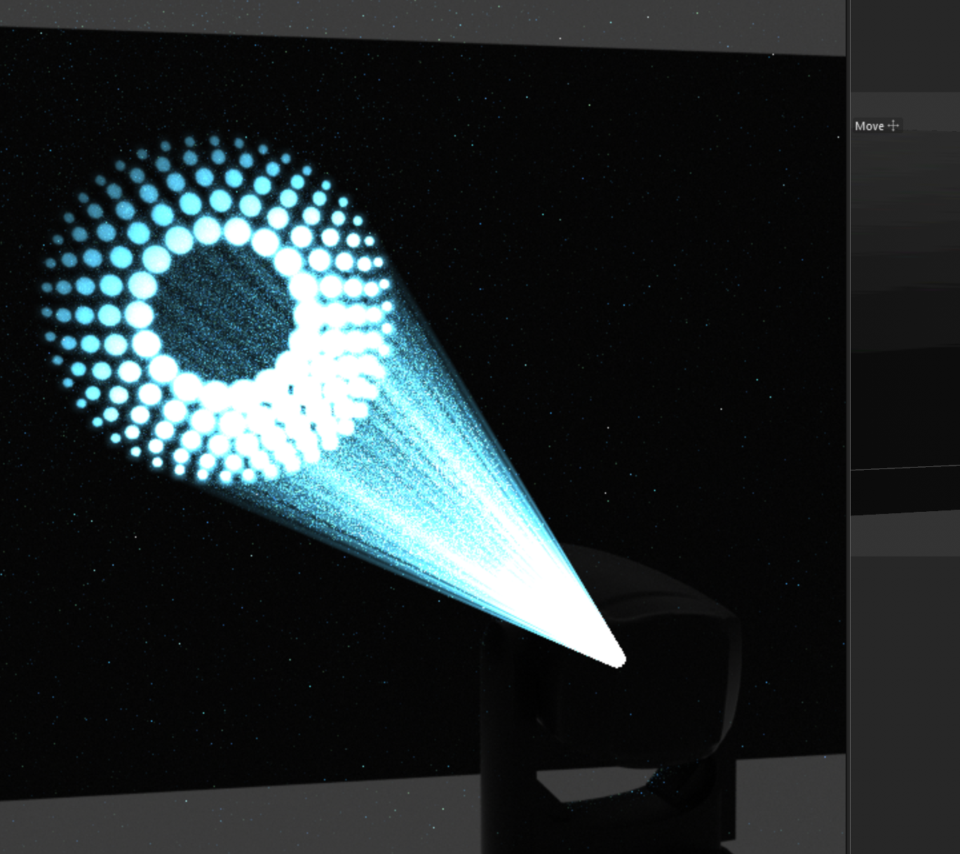

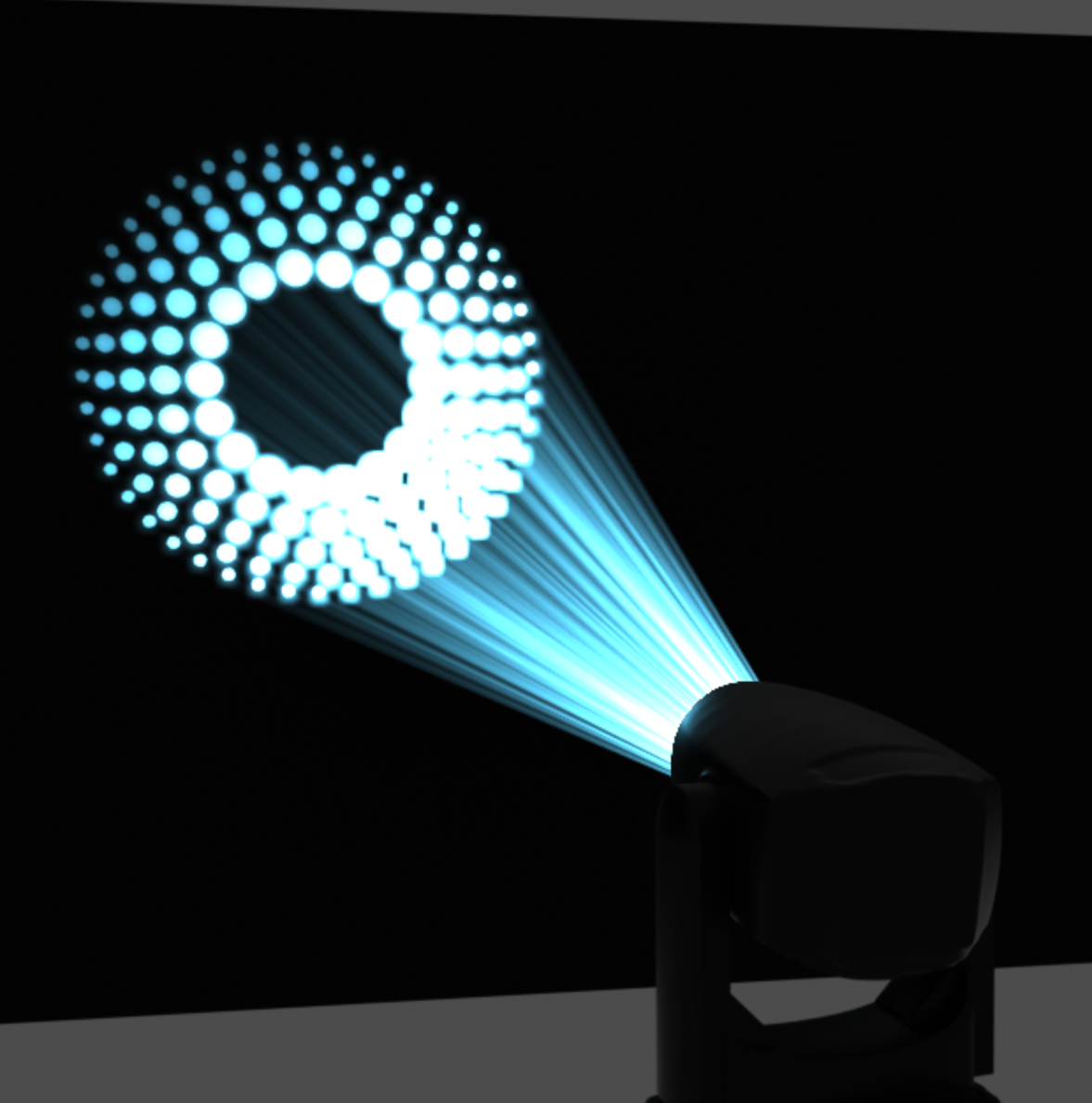

If an analytical light is inside a VDB Fog Volume, you can see it through geometry I reckon.
