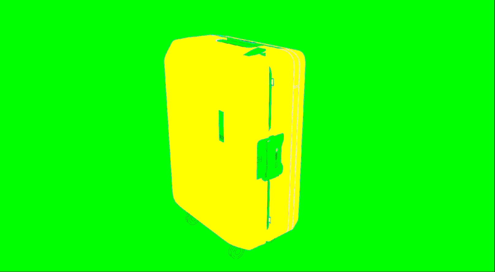

Hello there,
I'm having an issue with cryptomatte layers. When I render it in Live Viewer, it appears to operate OK, but when I render it in Picture Viewer, it does not. It is completely shattered. I save it as EXR (Octane), so the format isn't an issue. Do you have any clue where the issue is?

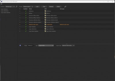

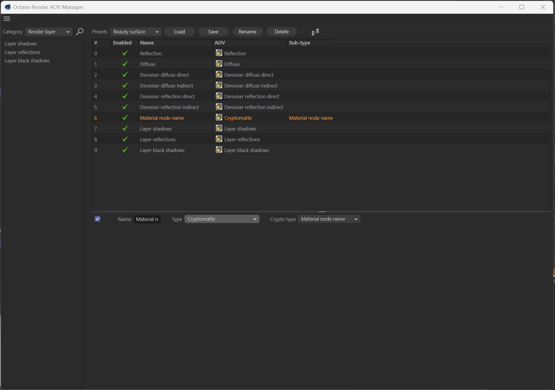

Please also share a screenshot from Render Settings/OctaneRender/Render AOV group tab, showing the Cryptomatte settings, thanks.

LeSill
Posts: 22
Joined: Wed Feb 16, 2011 2:57 pm
Here is the log:

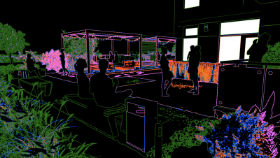

I also noticed that Cryptomate doesn't work in Photoshop using EXR-IO plugin. It works only as separate material masks but not as all in one color image.

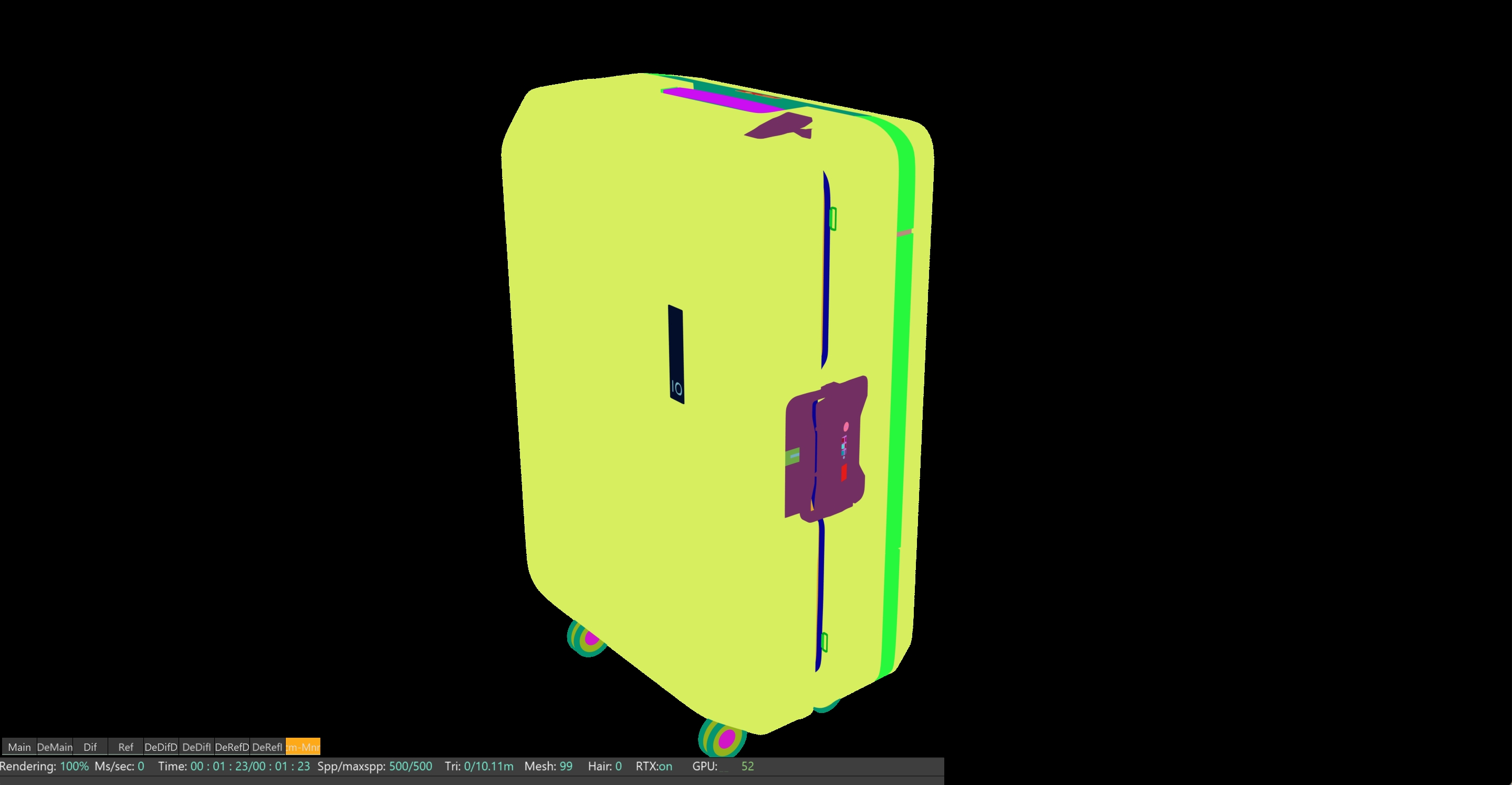

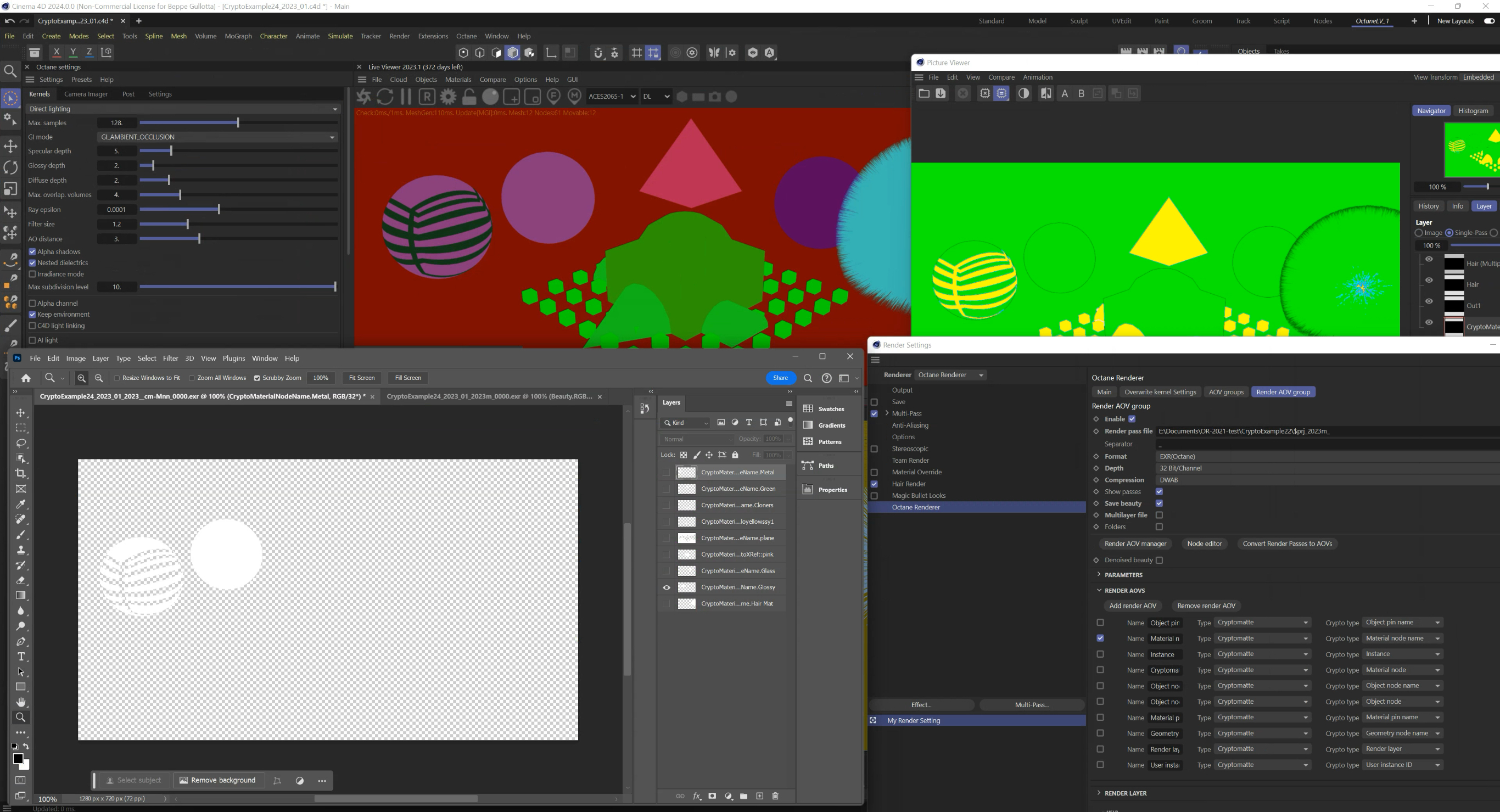

Posts: 10643
ok, unfortunately the log is not complete, and the exact version of plugin used is not visible.,
Anyway yes, Picture Viewer result is not displayed correctly, but it is not important, since the saved result is correct with Photoshop and EXR-IO:
ciao,
Beppe

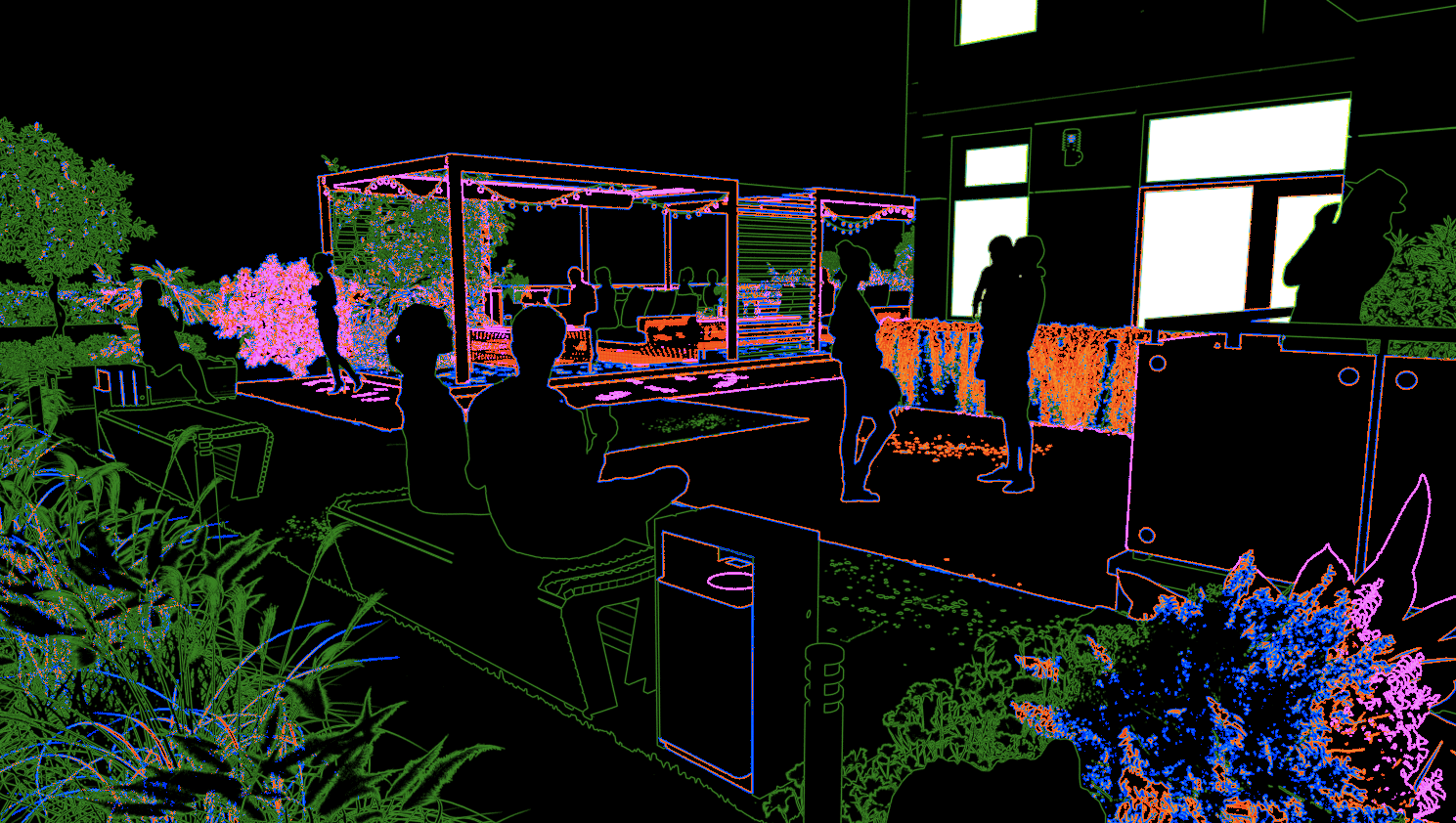

But why my cryptomates looks in Photoshop like this ?
Yes, cryptomate masks display fine in PS but you know that for large scenes you have dozens of different masks that is not good.
Architectural Visualizations http://www.archviz-4d.studio
Posts: 10643
Cryptomatte offers automatic masking, and can be very useful, especially with complex scenes, but can be used in different ways, materials, geometry, objects, ecc.
So, based on the structure of the scene, you need to find the mode that better suits for your needs.

Posts: 16068
Location: Türkiye
Nothing wrong with that in picture viewer. Crpyto colors are not one layer RGB data. What you see is in the LV that's just for your info with "false-colors", not for using in any compositing software. We call it as human-readable.
To see human-viewable crypto buffer that will broke the crypto colors for saved images. So your request is void for the Picture Viewer. You can check the colors in Live Viewer as always.
