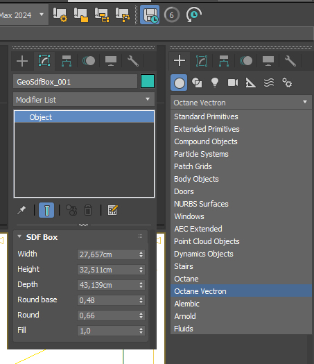

Hi leallolo,
You can use a Vectron geometry:
Create > Octane Vectron
Regards

Hi leallolo,
I apologize, I had forgotten the past, as mentioned by me in a post: "unit volume," a tool implemented in SDK version 2022. This way, you can overcome the limitation of 3ds Max not being able to create .vdb files natively.
viewtopic.php?f=51&t=82067#p426574
