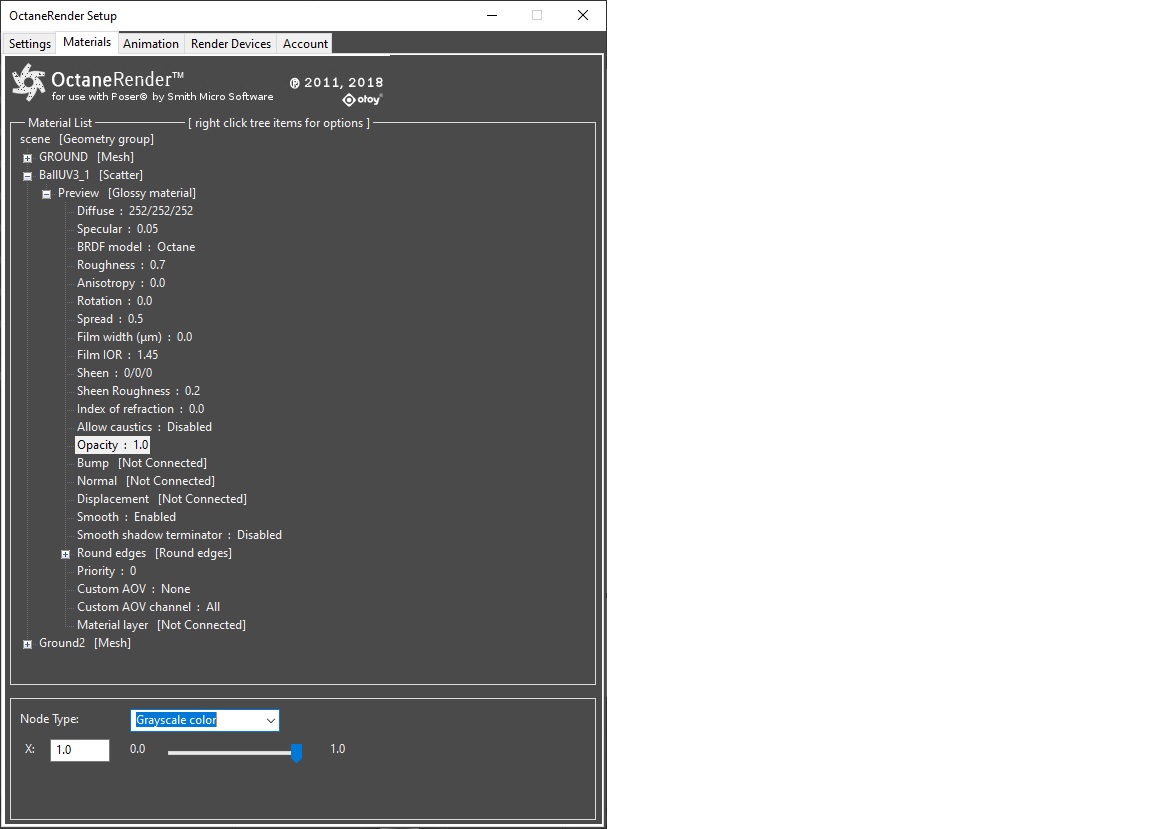

So, I think I figured out why I never used dial linking. It doesn't seem to show up in my materials tab, and to my knowledge it's never been there for me (see attached image). Unless I am doing something wrong or need to check something for it to show up?
*Edit: I got it working. There's a checkbox in "Setup" that needs to be checked. For some reason it was unchecked on my end. Thanks for the help though I am glad I got this working.
