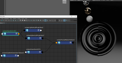

Hi everybody,
Is this possible to achieve this kind of noise ?
I have unpredictable result with a spherical proj.
Cheers

cant get a real solid setup :

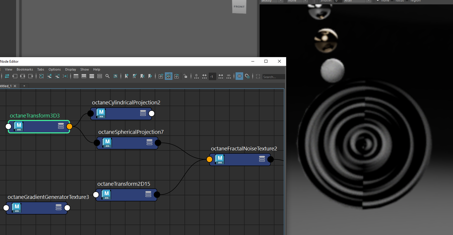

AdrienG wrote:cant get a real solid setup :
Hi AdrienG,
Thank you for the reference.
Is it something like the sample you are after?
Cheers
Adrien.zip
(9.61 KiB) Downloaded 526 times
Kind Regards
bk3d

Very cool it works thank you !
Despite the seam it s perfect. I guess with a mask and mix texture we could deal with that.
Different and same subject, i m trying to get the perfect radial anisotropy and found out the best tutorial about it :
https://lesterbanks.com/2022/08/working ... cinema-4d/
Gradient generator with gamma set to 1, invert ON. Projection UV. Transform set to -90 degres.
