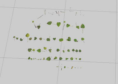

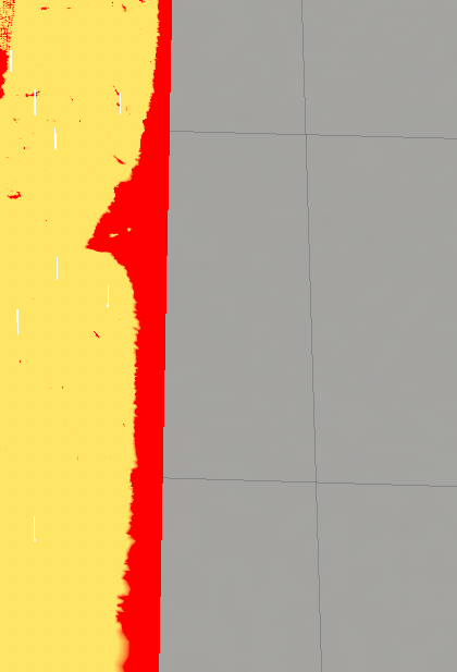

Hello all,

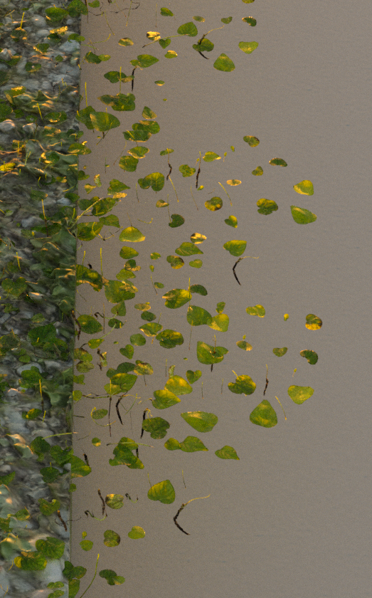

any suggestion why scatter is extending out of bound of vertex map?
It overall follows the shape of the map but the scatters extended outside of it..
Any idea what could cause that?

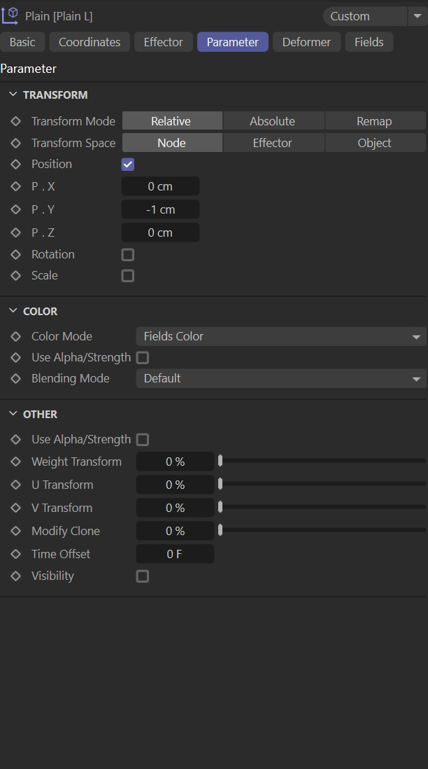

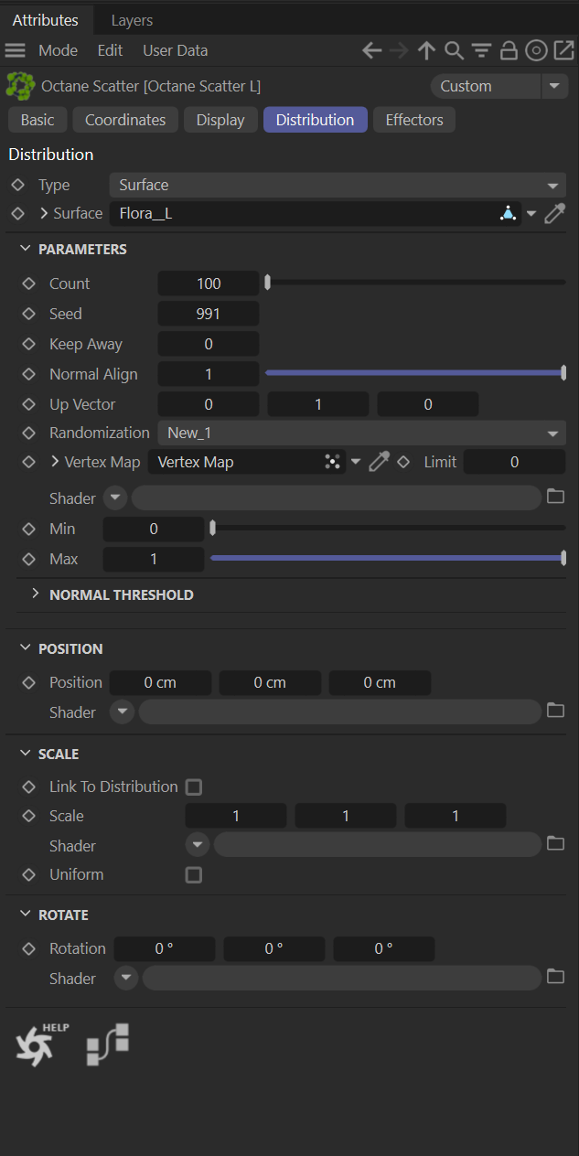

please share a complete screenshot of the Octane Scatter attributes.
ciao,
Beppe
geoyeo
Posts: 34
Joined: Mon Mar 29, 2021 8:43 pm
Sure here they are
Settings
Settings
Plain Effector
Plain Effector

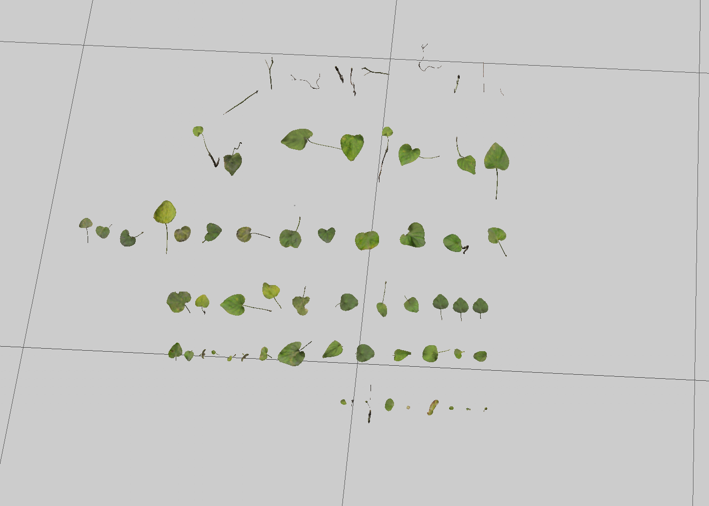

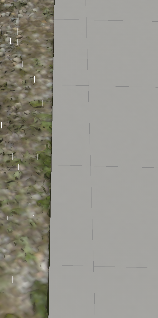

Could the issue be related with the initial position of the scattered objects?
What should be the initial position? all items at 0,0,0 XYZ ?
Win 11 64 | RTX 4090 | Ryzen 9 5950X | 128GB Ram
Posts: 16068
Location: Türkiye
geoyeo wrote:Could the issue be related with the initial position of the scattered objects?
No but PSR of objects will be overwritten. Keep the pivot points are almost centered

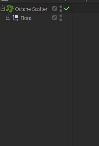

and is ok to have the object nesting the objects in a folder?
