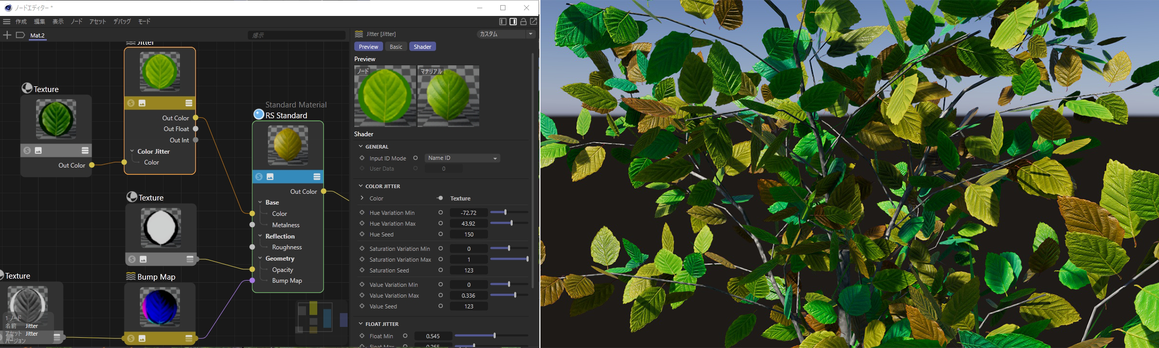

Hello sir, is there such a node that can directly read the random color of the model separated in a single object. Or osl will do. Nodes like Redshift

MyDearestHao wrote:Hello sir, is there such a node that can directly read the random color of the model separated in a single object. Or osl will do. Nodes like Redshift
Every year we have more limitations compared to Redshift...
Try this capsule which generate random vertex map by polygon islands and use this vertex map to drive colors in Octane material :
Attached scene from Octane 2023 beta
rand sel.zip
(9.27 MiB) Downloaded 188 times
Thank you for sharing this file. Have been looking for something like this for some time now. Didn't know C4D had this feature.

Kalua wrote: Thank you for sharing this file. Have been looking for something like this for some time now. Didn't know C4D had this feature.
Regards,
Unfortunately C4D doesn't have such feature so I made it using scene nodes because I needed this too for tree objects which doesn't have different selection tags or materials for leaves.
