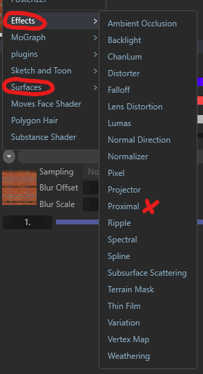

I don't know how it works in previous versions but all C4D effects and surfaces works fine in Octane as baked ones except Proximal.

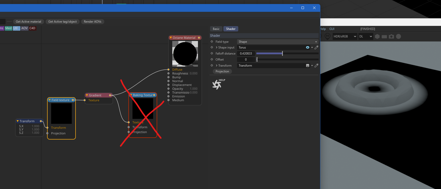

Field texture in Shape mode doesn't work with Baking texture node but it works in other modes. Scene included.

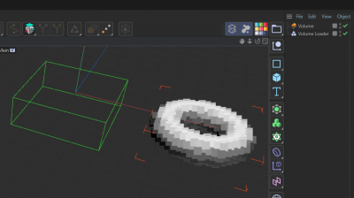

Volume exported from C4D and loaded to Octane is empty :

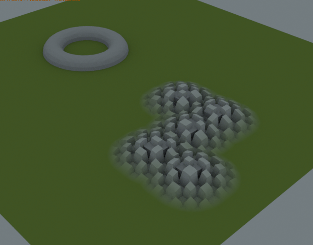

You can already drive vertex displacement by regular Sdf objects using field texture node with gradient. Unfortunately there is bug in c4d Octane while using mesh to sdf which doesn't fully works.

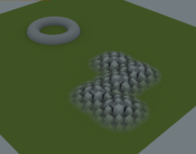

yeah, actually I was testing it here and I made a selection with the vertex map where I would like to apply the displacement texture, but it doesn't work. I did the same test in redshift and it worked, I also asked a friend to do it in blender in cycles and it works perfectly too. So my question was how to do this in octane material, but from what I saw at the moment it is not possible to use the vertex map as a selection to apply the displacement map texture.SSmolak wrote:You can already drive vertex displacement by regular Sdf objects using field texture node with gradient. Unfortunately there is bug in c4d Octane while using mesh to sdf which doesn't fully works.
Look on attached scene. It works fine for regular SDF but not for "mesh to SDF". It is broken.
