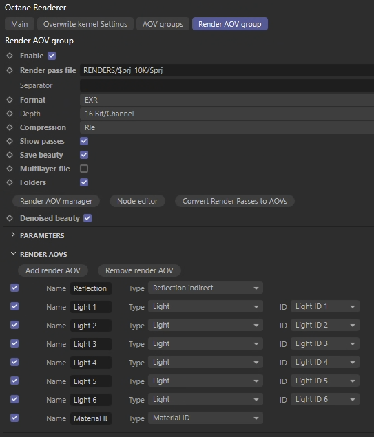

I'll be happy to try this Octane version (and futur R6) but later as I'm working on some stills that I need to deliver soon. I'm still very very new to Octane, but since last night I've been able to get all my passes and the denoised beauty like this with the R5 (but it’s with “EXR” format and not “Octane (EXR)”). FYI.

Thanks aoktar but with 'Octane(Exr)' and Show Passes OFF, I sometimes get the MID pass completely black (it's OK in the Live Viewer). I don't have this problem if I choose 'Octane'. (And also sometimes the first frame is not saved on certain passes).
Can I PM you this scene so you can test it and see if MID pass is not black on your side?

Thanks aoktar. I tried this version and still the same behavior than R5_fixed (MID is ok in Live Viewer but rendered black).
