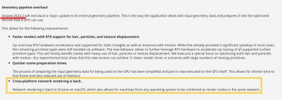

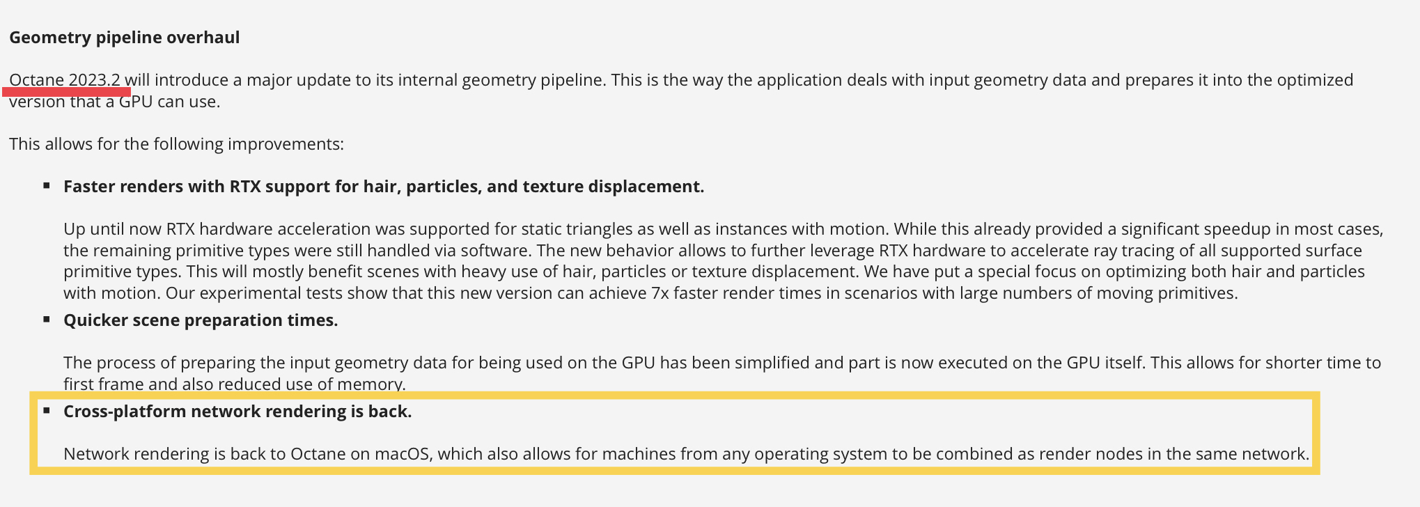

What is the current status of cross platform render node setups? I still have an intel mac and a pc with RTX series cards… is network rendering enabled yet between the 2 sides yet?
If it does work.. and SDKs are finally synced… is there a setup guide or video for setup?
Also i am on an intel mac at the moment
Posts: 10564
full cross-platform Network rendering works only under CUDA for now, so you should need to have an old Mac with GTX Nvidia GPU inside, High Sierra, and OctaneRender 2020.2.5 max.
From 2021.1 SDK, Network Rendering works only with Windows and Linux nodes.
Intel Mac can Net render only with Intel Mac nodes.
But the devs have just published 2023.1 Alpha version:
viewtopic.php?f=33&t=81650
And full cross-platform Network rendering is going to come back with 2023.2 SDK:
viewtopic.php?f=33&t=81650&start=10#p424367
ciao,
Beppe
