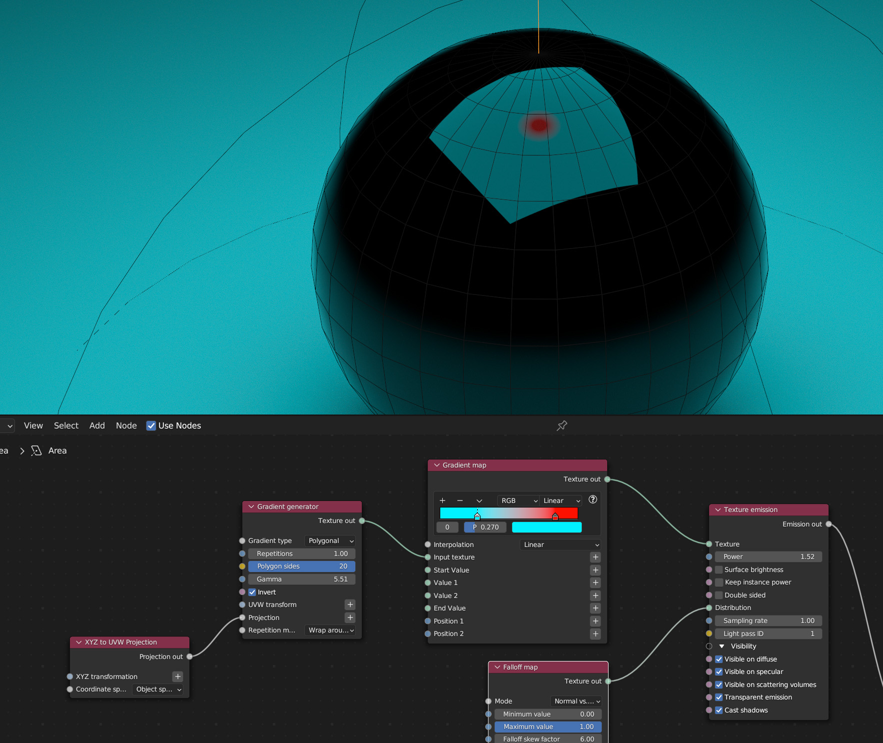

Below is a setup where a Gradient Map node is between a Gradient Editor and a Texture Emission node. Any changes I make to the sliders (moving them, adding new ones) isn't updated in the viewport. I have to disconnect and connect some node to trigger the update. I would upload a Blend file, but as you can't use them, it makes no sense.
V27.15, Windows 10, RTX 3060
Gradient changes not updated in lights

Sure, we can use blend files, as long as the issue is an OctaneBlender problem, not an engine one.
I've made a similar scene, by the way. Let's see if this is something we can fix! Thanks!
