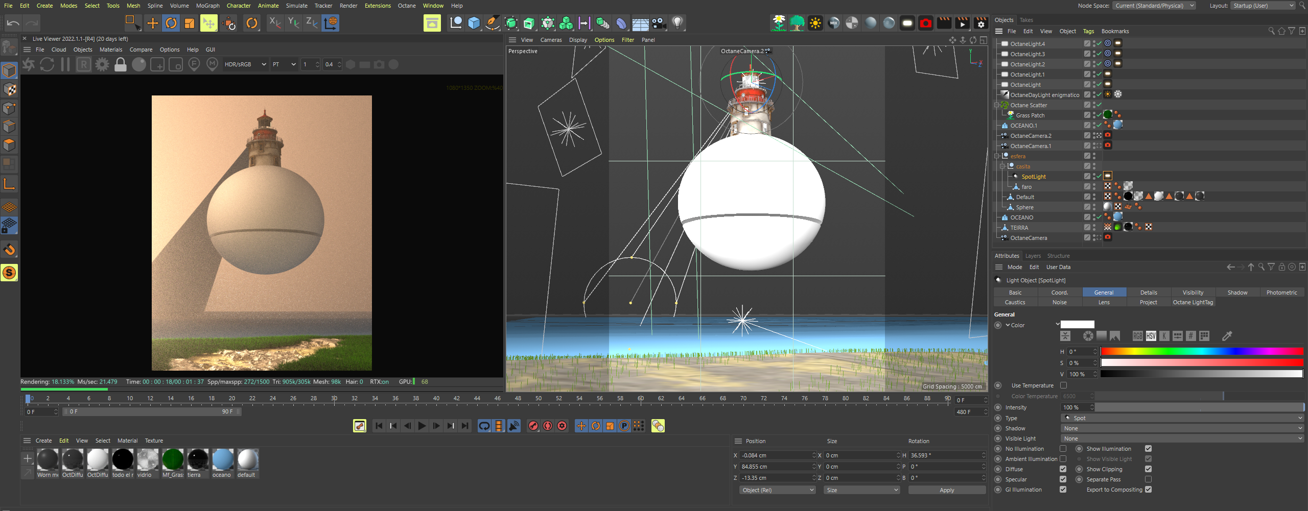

Hi everyone,
I'm working on a scene where I want to recreate the light produced by a lighthouse. It doesn't have to be physically correct, I'm just looking for a result that looks good aesthetically. I tried to do it using a spot light, but it generates these very sharp edges that I don't like.
Does anyone have any ideas on how I could make the light look better? I'm open to any suggestions.

Posts: 10532
do you have a Scattering Medium node in the Environment node?
If yes, try to use a small Area Light, with SpotLight Distribution node in the Distribution slot/pin, instead of the Volume SpotLight.
ciao,
Beppe

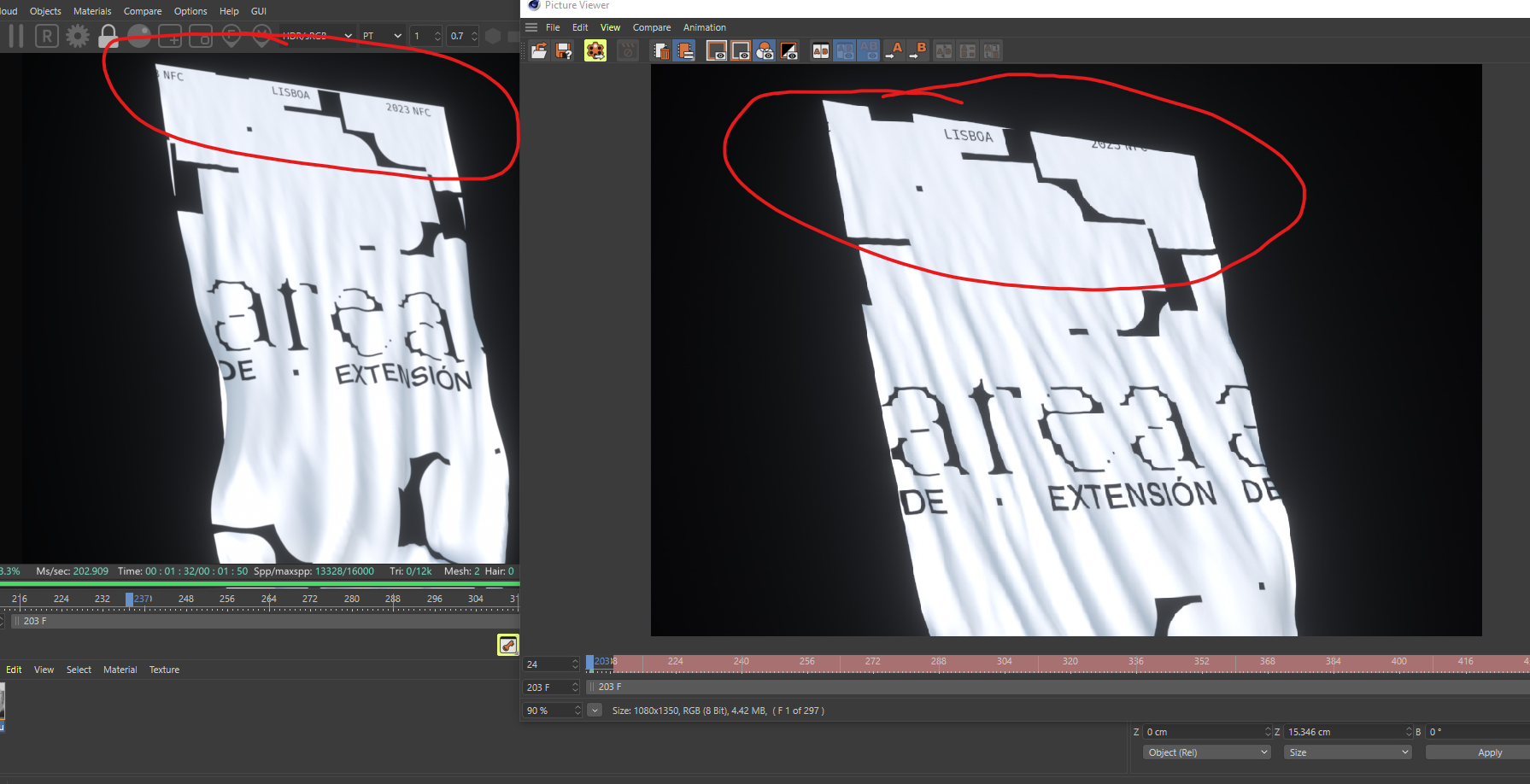

Grazie Beppe! Can you help me out whit this also, I am doing a render and what I see on the preview is not what is coming out in the render.
I am using a transform node in my texture to make it fit well, but this is happening!

Posts: 10532
You are welcome :)
About the texture transform issue, difficult to say...did you cache the simulation?
If yes, please share the scene with texture via Private Message, thanks.
ciao,
Beppe
