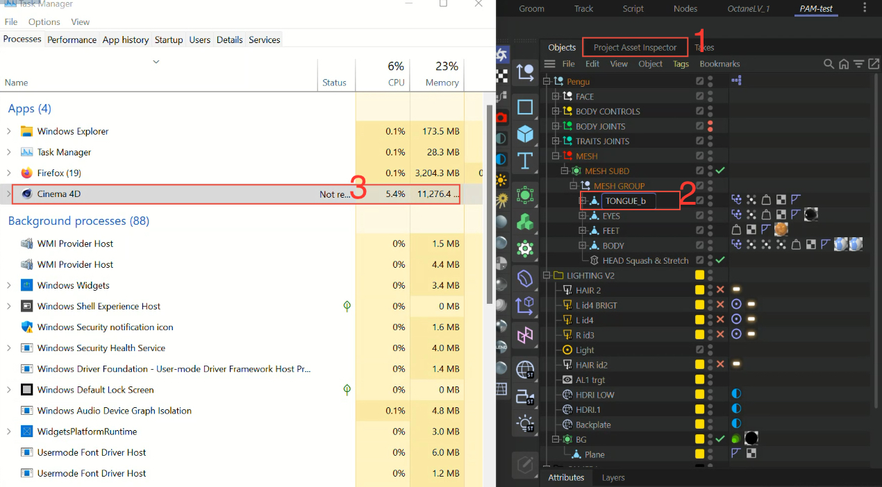

Hi guys. This problem has been plaguing me recently with C4D 2025. I know this is an old thread, so I'm not sure if the issue has been solved yet, but I have narrowed down the culprit being the Project Asset Inspector inside C4D being docked in the workspace. When I remove mine the issue is gone. And I noticed that you have it docked also.
Please verify if this is the case on your end as well and maybe we can get this issue fixed.

Posts: 10611
Ok, now I can reproduce it, you need to load the layout with Project Assets manager window docked in before loading the scene.
Here is the layout I have used:
