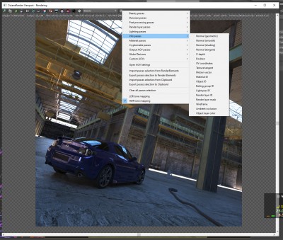

About the z orientation, it must be set in your compositing software.
Said that, could you tell me which pass you need but not available?

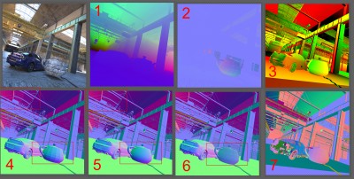

1) Position - A color-coded image that shows the position of the objects in the scene.
2) Tangent (Local) Normals - A color shows the Tangent (Local) Normal in tangent space at the position hit by the camera ray.
3) Texture Coordinates - A color-coded image showing a Gradient map based on the direction of the object’s UV texture coordinates.
4) Geometric Normals - The vectors perpendicular to the mesh's triangle faces.
5) Smooth Normals - Shows information on the integrity of the model's geometry in terms of the normals perpendicular to the mesh's smooth underlying surface.
6) Shading Normals - The interpolated normals used for shading. This does not take into account the object's Bump map. The result is less faceted and smoother than Geometric Normals.
7) Texture Tangent - The first tangent vector. This determines the Normal map distortion's orientation.
