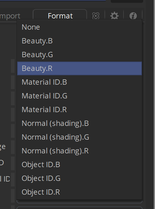

hi Paul,
thanks for the latest update. i tried the 16 bit exr option and the Denoised layer is still missing
do i need to do something other than enable Denoise to have it show up?
attached shows available layers in Fusion Studio
EDIT: same issue in Affinity Photo - no Denoise pass

Does this version of the plugin resolve your issue please? https://render.otoy.com/customerdownloa ... STUDIO.exe
Paul
Dingbat
Posts: 180
Joined: Tue Jul 21, 2020 7:49 am
hi Paul yes this version works as expected
thank you
