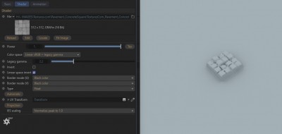

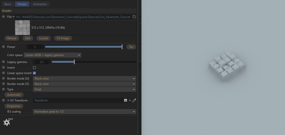

It works fine for me without repeating :

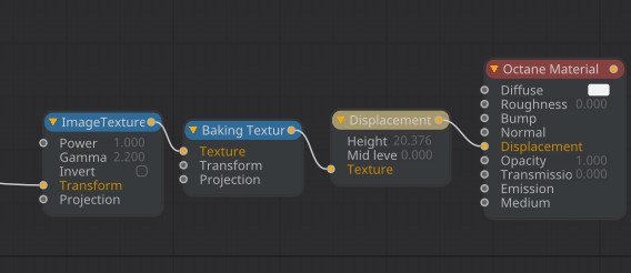

Yup, the trick is to bake the texture before it hits the displacement node.
