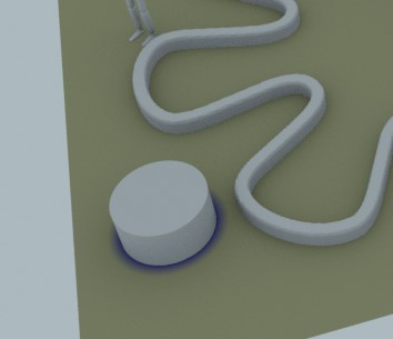

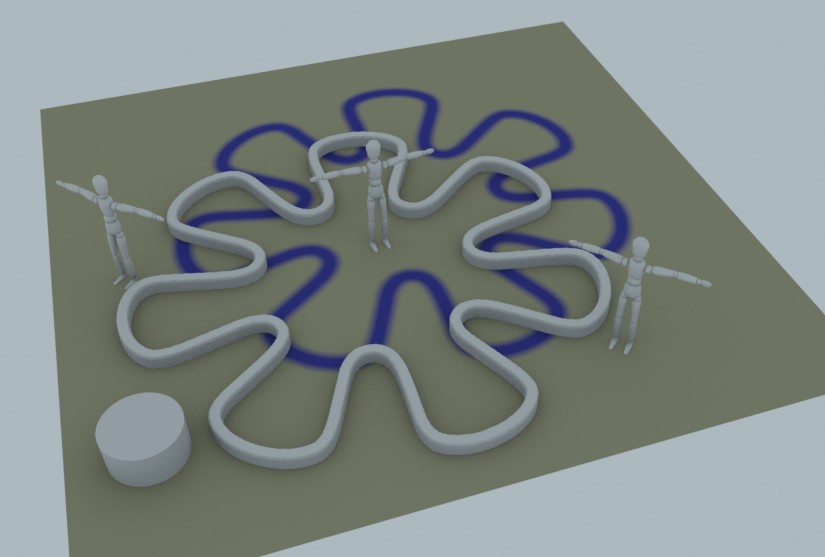

aoktar wrote:New build (R4) is out with some fixes! Enjoy it!
Thank you for Shape Fields ! It is very powerfull for creating dirts around chosen objects. But I found two issues :
1. It doesn't work correctly for sdf from objects ( space translation issue )
It works fine for regular sdf's
2. Using SDF's in scene cause crash while restart rendering.
3. Field Shape doesn't work while connecting Projection node to it.
Scene attached.
field_sdf.zip
(447.51 KiB) Downloaded 119 times
Architectural Visualizations http://www.archviz-4d.studio
