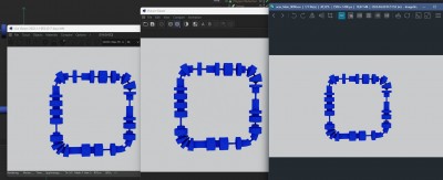

It's not a thing which is related to plugin. Octane core doesn't work with that. But devs may be working on to add a support for it!thanulee wrote:Hey bud, with aces u dont need highlight compression. But I agree yes, we need more color correction controls and core devs are aware of that and its coming over the next versions afaik. Cheersgifmotion wrote: Why would they go and disable this.
Aoktar - Please re-enable this feature as Aces has a great look but is very limiting with the use of highlight and gamma abilities
Hey Aoktar,
The thing is, previous version of the plugin (2021) allowed this control?
So something has changed in 2022 to restrict it.
I'm also finding it difficult to get out my aces rec709 live viewer render the same in the picture viewer. In 2021 I was able to control aces tone mapping that would further allow highlight control and gamma. And then what I saw I could render in as png from Picture viewer.
This is an ideal workflow as a lot of the time I don't want to either deal with Exrs, AOVs or converting color space in After Effects.
I understand Arron Westwood comment about why you don't have control of highlights/gamma. But for many artists. We want to use the beautiful look that we see from Aces and then have the choice to still further art direct.
I know its not 'Accurately' the right way of working. But for artists like myself. Its about speed and efficiency and have the liveviewer being the final image a lot of the time.
Does that all makes sense and can you answer why 2021 offered this but 2022 isn't?
Thanks,
Dean
Thanks,
Dean
Just uploading a quick video of me using aces when in 2021 and how it worked.
Dean
Dean
- Attachments
- Cinema_4D_R25.121_-_[Untitled_1_]_-_JOB_NAME_230427_12.46273.mp4
- (6.43 MiB) Downloaded 1594 times

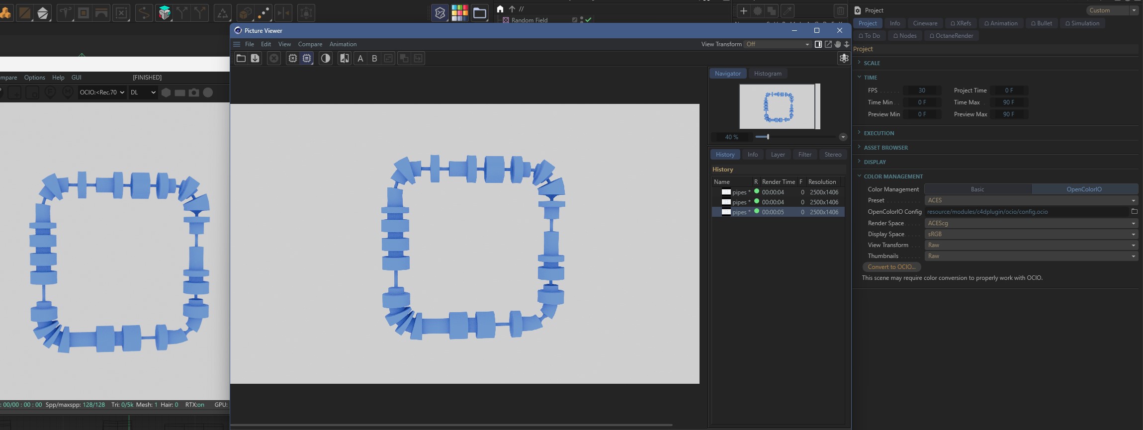

You must use Cinema 4D 2023 to enable OCIO color in Project preferences and Image Viewer.

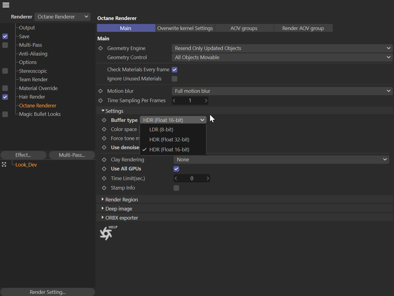

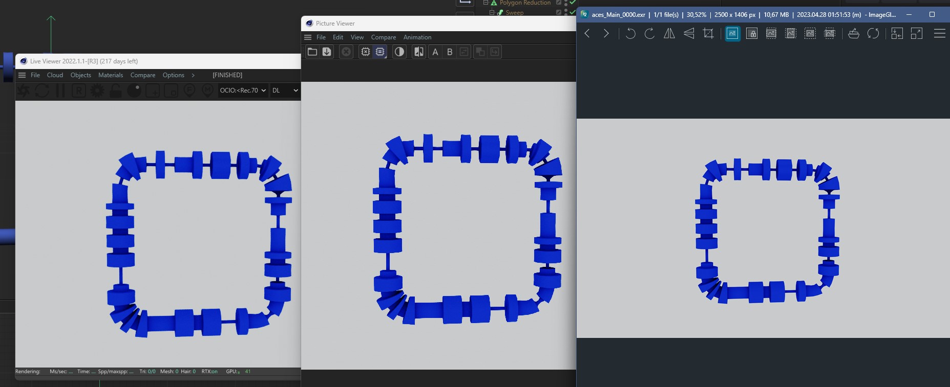

It looks exactly the same in Pictue Viewer even using force tonemap with highlights and gamma corrections applied to ACES. Don't use ACES via Ocio and in Camera Imager at once while force tonemap is on - it will double ACES effect.
rendered out ( gamma, highlight, exposure ON :
