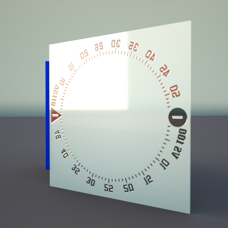

I think I got your point. Here's another quick render, with much more variations in the HDR. I also took one with higher resolution in order to get sharper transitions...
(I also tried replacing the bump map of the ring with a normal map but the result is not what I expected)

Hi yoyoz, very nice render.
About the normal map, it is an "Image" texture and work good on small values.
Could you post it here?
The paper has no wrinkles and no botches, looks brand new. :mrgreen:

yoyoz
Posts: 451
Joined: Sat Dec 25, 2010 9:59 am
Location: Belgium
The fist render used the bump map below, it looked fine to me but I wanted to get more deepness. Second one is my first attemp with a normal map but it seems you need to build it with knowing in advance where the light will come from in order to achieve a good result. It also looks like I've made it in the wrong direction (numbers and marks are below ring surface on my real watch).
I'm just a newbie experimenting ... ;)
Any idea on how degradating the paper?

Should work.
Cheers, mib
Edit: ocs file messed up, i changed it.
cube.7z
(128.9 KiB) Downloaded 314 times
