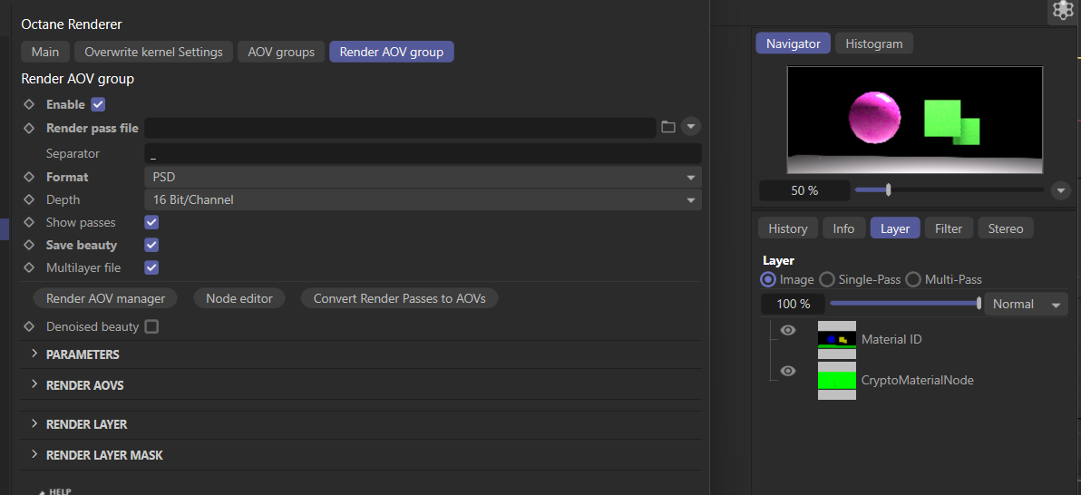

Rendering by c4d picture viewer, file is with multipass layers but dont have "beauty" background layers. Did I miss any multipass to get beauty layer..?
thanks.
No Beauty layer in PSD ?
Please, share a screenshot from render settings/OctaneRender/Render AOV group tab, thanks.

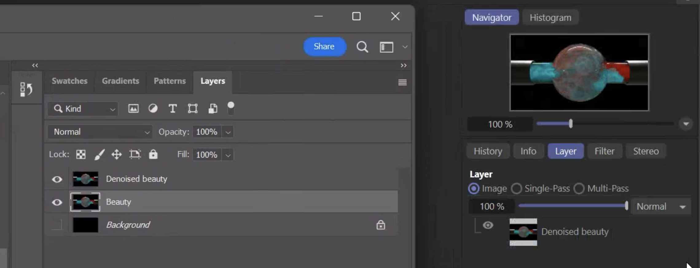

Please enable the Save Beauty option in Render AOV group tab, then open the .PSD file in Photoshop:

As in my last post... beauty layer not saving.

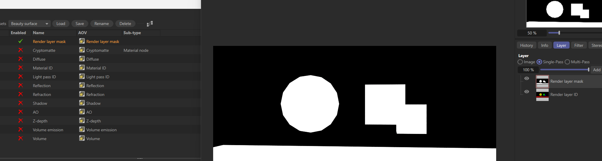

Here is sample scene file and some screen shots.
Thanks.
Thanks.

Try inputting a save path for the PSD as per screenshot, then open the generated PSD. That worked here for me. Rendering to the Picture Viewer without a save path apparently means no beauty.
