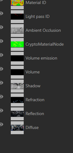

Rendering by c4d picture viewer, file is with multipass layers but dont have "beauty" background layers. Did I miss any multipass to get beauty layer..?

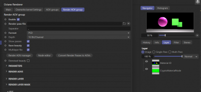

scene rendered with PV, and here is setting...

Not in front of my work computer at the moment, so can't test anything, but have you tried checking the "save beauty" check box towards the top of the settings?

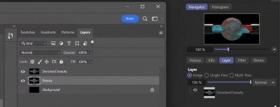

Tried... its not saving beauty layer.
Posts: 10643
Please enable the Save Beauty option in Render AOV group tab, then open the .PSD file in Photoshop:

As in my last post... beauty layer not saving.
Here is sample scene file and some screen shots.
Thanks.

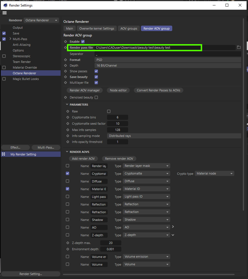

Try inputting a save path for the PSD as per screenshot, then open the generated PSD. That worked here for me. Rendering to the Picture Viewer without a save path apparently means no beauty.

adding file name it work. thanks.

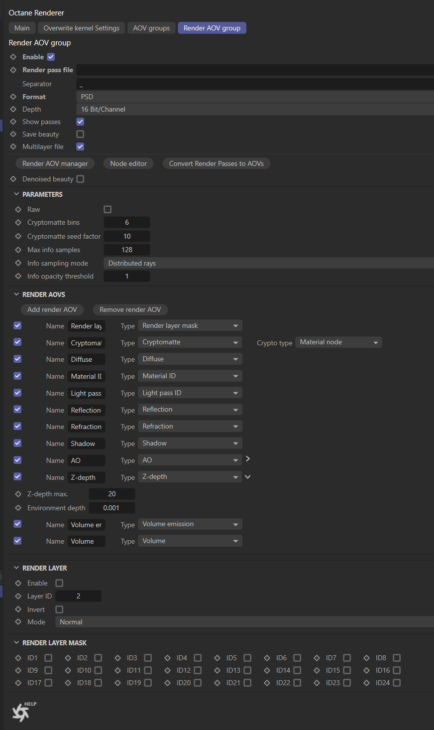

- how can I get each object separate mask...?
added object tag and layer id 2 3 4 but its coming mask all in one.
