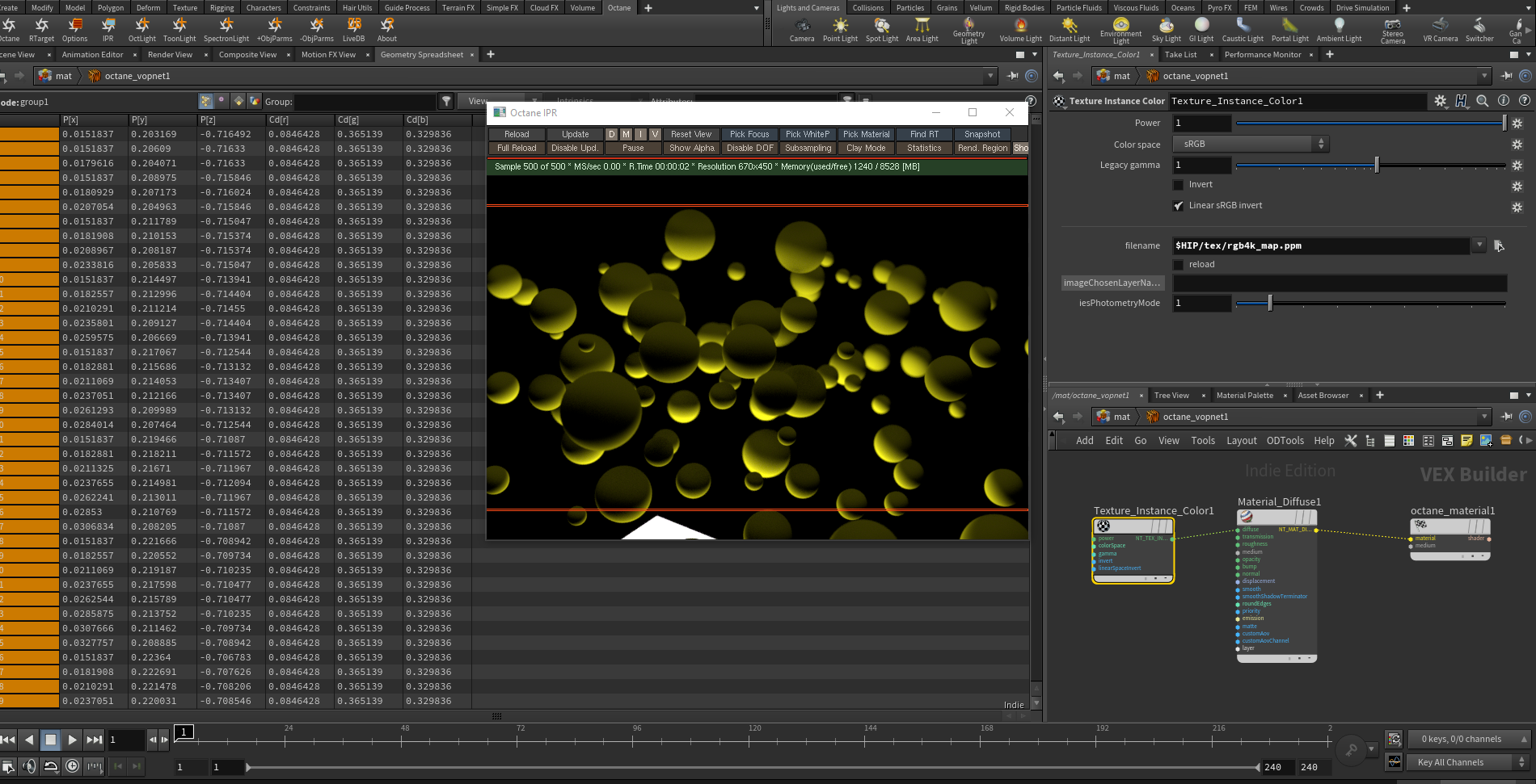

Hey there,
I'm cloning spheres on a sphere with copy to points and a attribrandom on Cd.
When I try to decode the Cd value for octane with the ppm map, the spheres just turn yellow.
I think I'm missing the instance attribute, but not sure where to create it.
Probably a dumb question, but I'm pretty new to houdini.
Thanks,
Alex
TheNikand
Posts: 32
Joined: Mon Jul 11, 2011 11:09 pm
Hi, you probably haven't enabled packed geo instances in octane properties
mirocreative
Posts: 47
Joined: Fri Jan 17, 2014 2:26 pm
Location: New York
Hey Alex,
yeah, you'll need to enable Pack and Instance on the CopyToPoints SOP and also Packed Geo Instancing for the object on the Octane - Properties tab.
If you don't need instances, you can simply pass the Cd attribute to Octane / Octane tab - Attributes Point float and Point vector set to Cd. In this case you'll need a Color Vertex Attribute with Cd in the name field connected to baseColor (diffuse) for the material to work.
