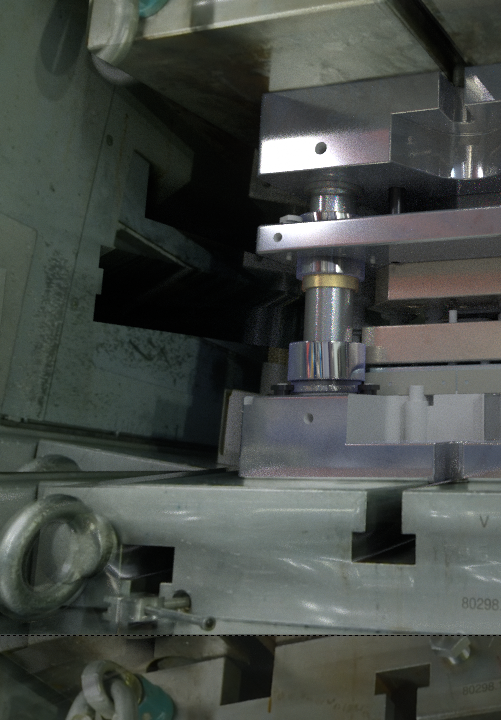

I have done a camera match moving by Blender3D-Tracking feature.
Now I want to bake the camera projection from the background in camera object to the reconstructed objects.
I must turn the 3d render camera a bit and for the objects must have fixed texture.

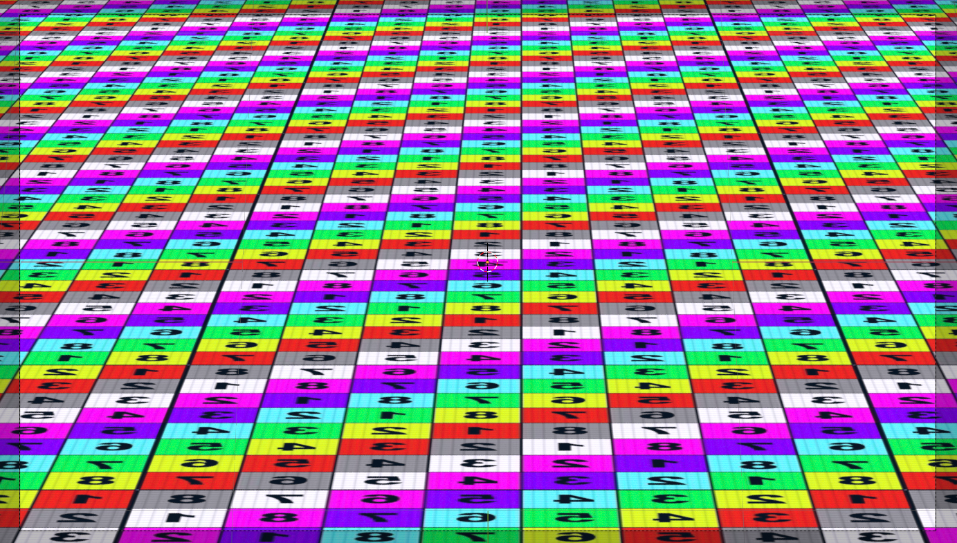

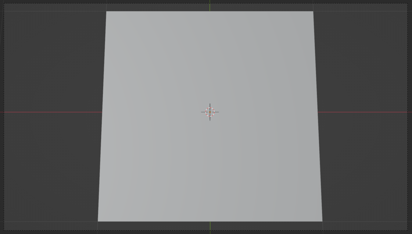

Here are my actually result with transform the UV.
Should the angle of the lines from the square the same like the lines in the projected UV-Color image?

In the filmed clip the cam move to a object and ends where I must start my visualisation.
In the visualisation I do a cut of it to visualize the function.
I don't want to blend out the movie clip into black background.
I want to move to blend into the render cam and move it near to the object.
And then the movie clip hide.
The 3D should blend into the filmed background. Then Blend in the textured Object for turn the cam in one second.
For moving the render cam near to the object with a little turn the texture must fixed to the objects.
In this time the camera front projection had no more images and I must render the environment baked onto objects.

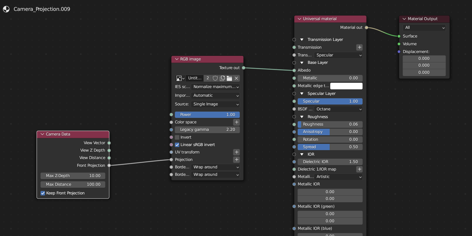

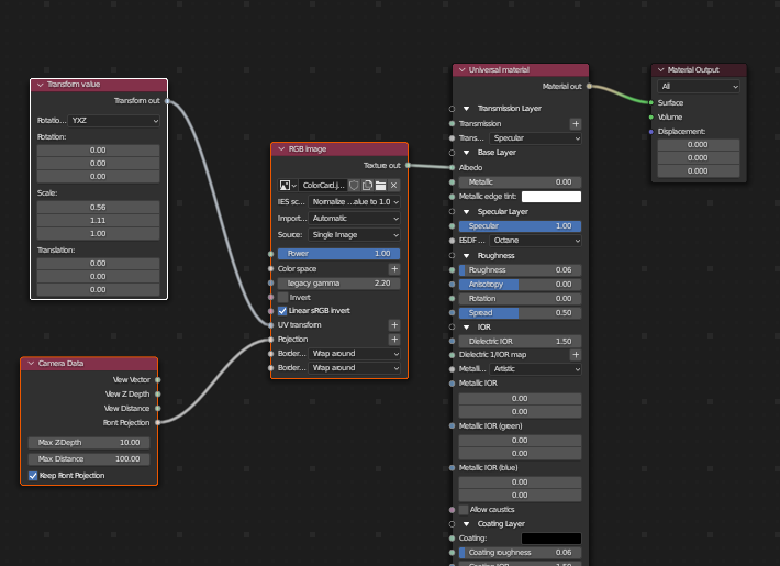

If you use the Keep Front Projection option, you'll be able to fix the projection itslef to the object is mapped to.
Just turn the option OFF and define the position of the texture. Then it will "stick" to the object when the camera moves.

Thank you - sounds great.
But I have not enought experience with blender.
How to stick?
I try to disable front projection. I try some projection nodes to stick the texture.
Not working.
"and define the position" - I don't know how...
Do you meaning UV-Transform Input with UV-Tansform Value Node?
Only Position changing?
How to stick?
Not working.

You need to use a Transform Node in the UV Transform of the Image Node, changing position and scale in any frame so the image will match the mapped object exactly as you need.
And yo need to do that with Keep Front Projection OFF.
