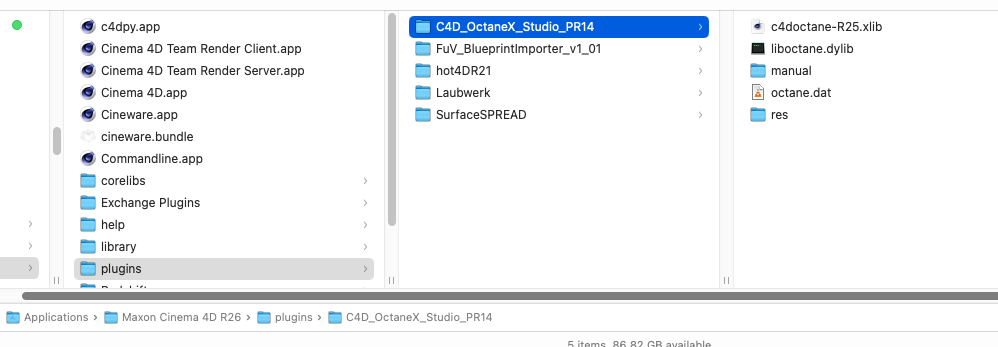

For C4D S26 and PR14, you need to keep the R25.xdlib file, and remove the other .xdlib unused files.

H Beppe, Octane login window does not pop up on C4D S26 startup.
And this is what I get, a glitch no menu under octane, see attachments.
Any clue?
R25 is working fine but not Cinema 4D 26.110
Screenshot 2023-03-31 at 09.16.58.png (40.83 KiB) Viewed 87631 times

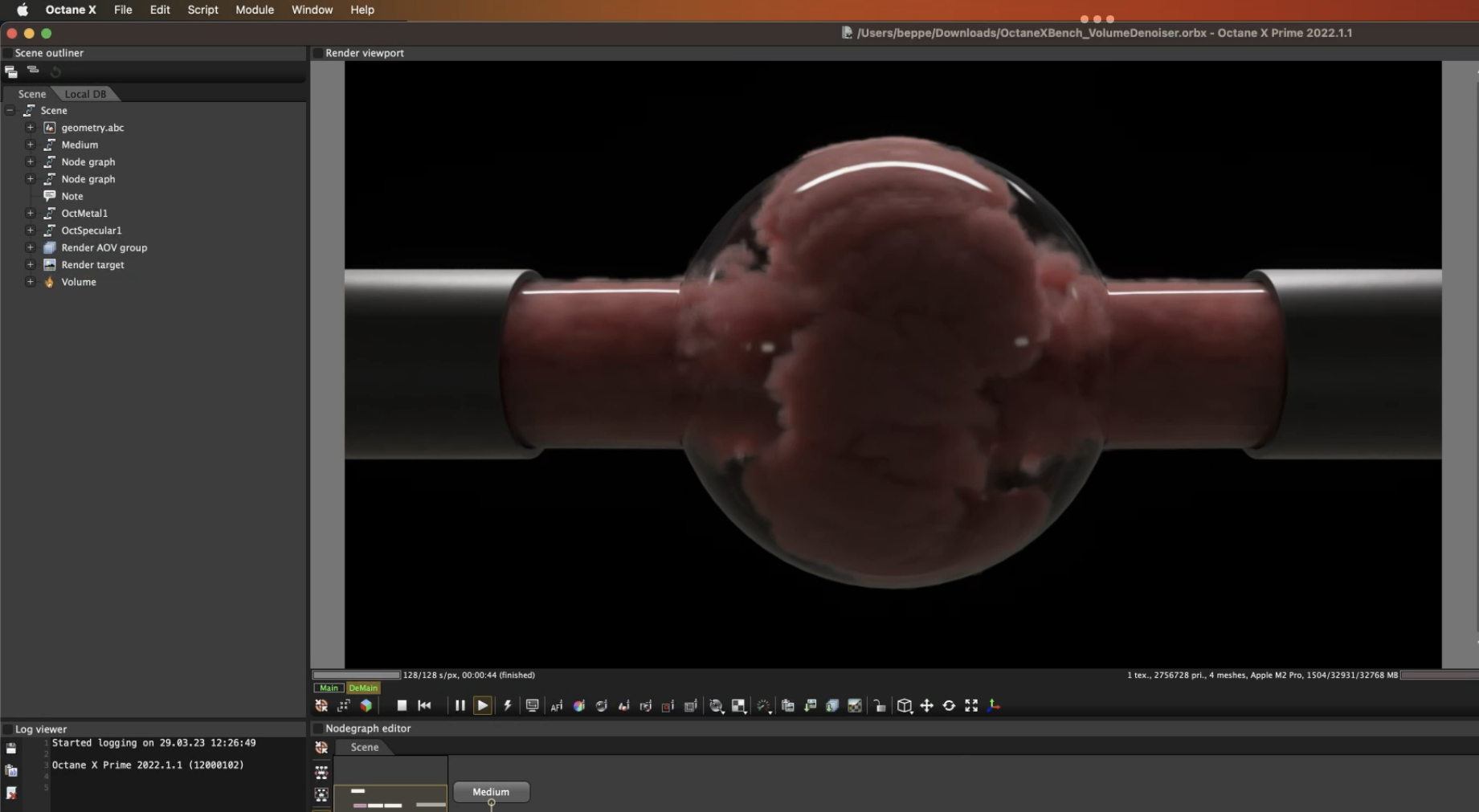

Yes confirmed, the speed improvement is huge :o
Thanks for sharing M1 Max result!
M2 Pro renders in 44", instead of 64":
I need new results from M1 Ultra, M1 Pro, and M2 Max, so I can update the speed chart.

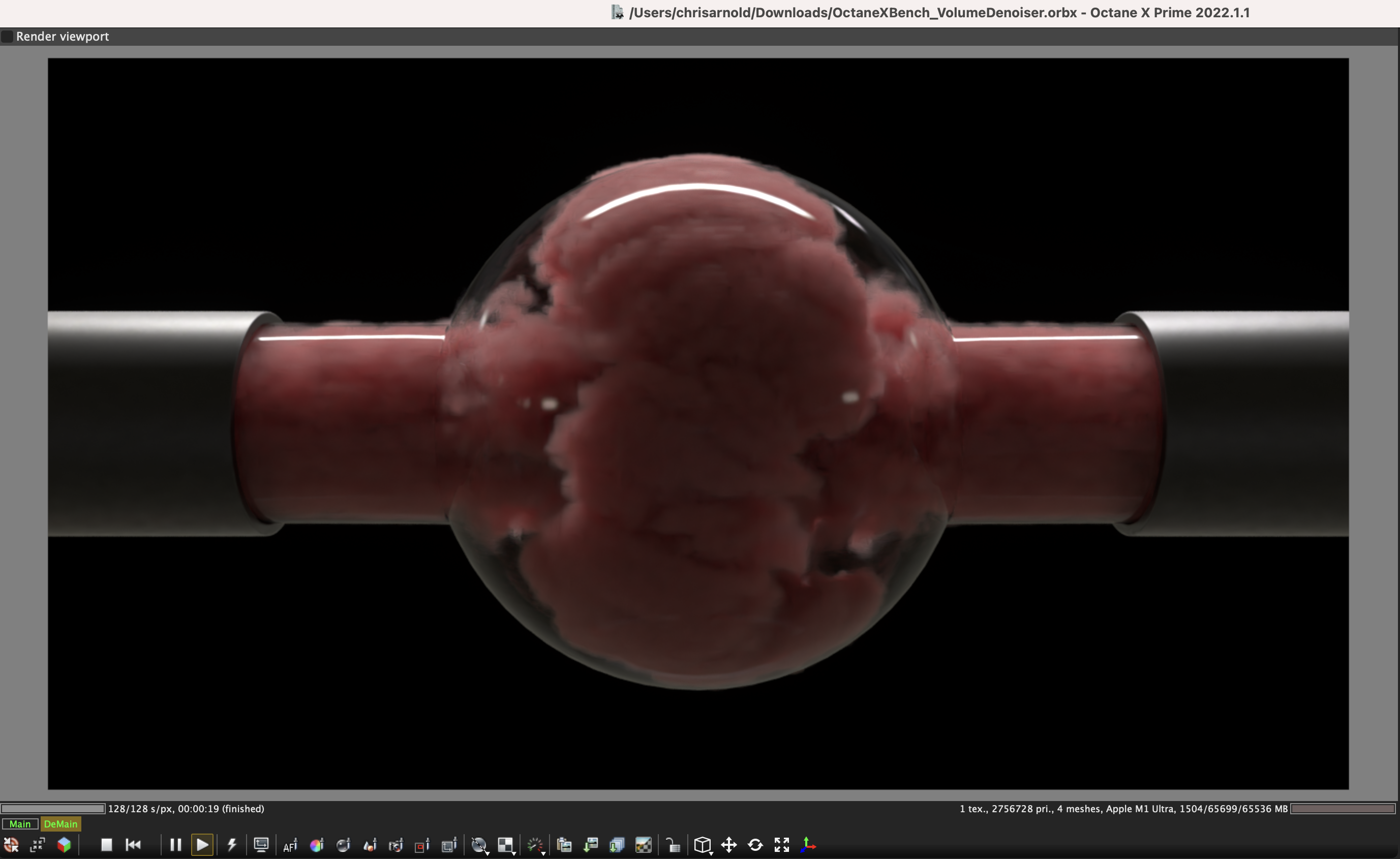

Mac Studio with M1 Ultra (64-core GPU) renders in 19 seconds, previously 26 seconds. A 37% speedup:

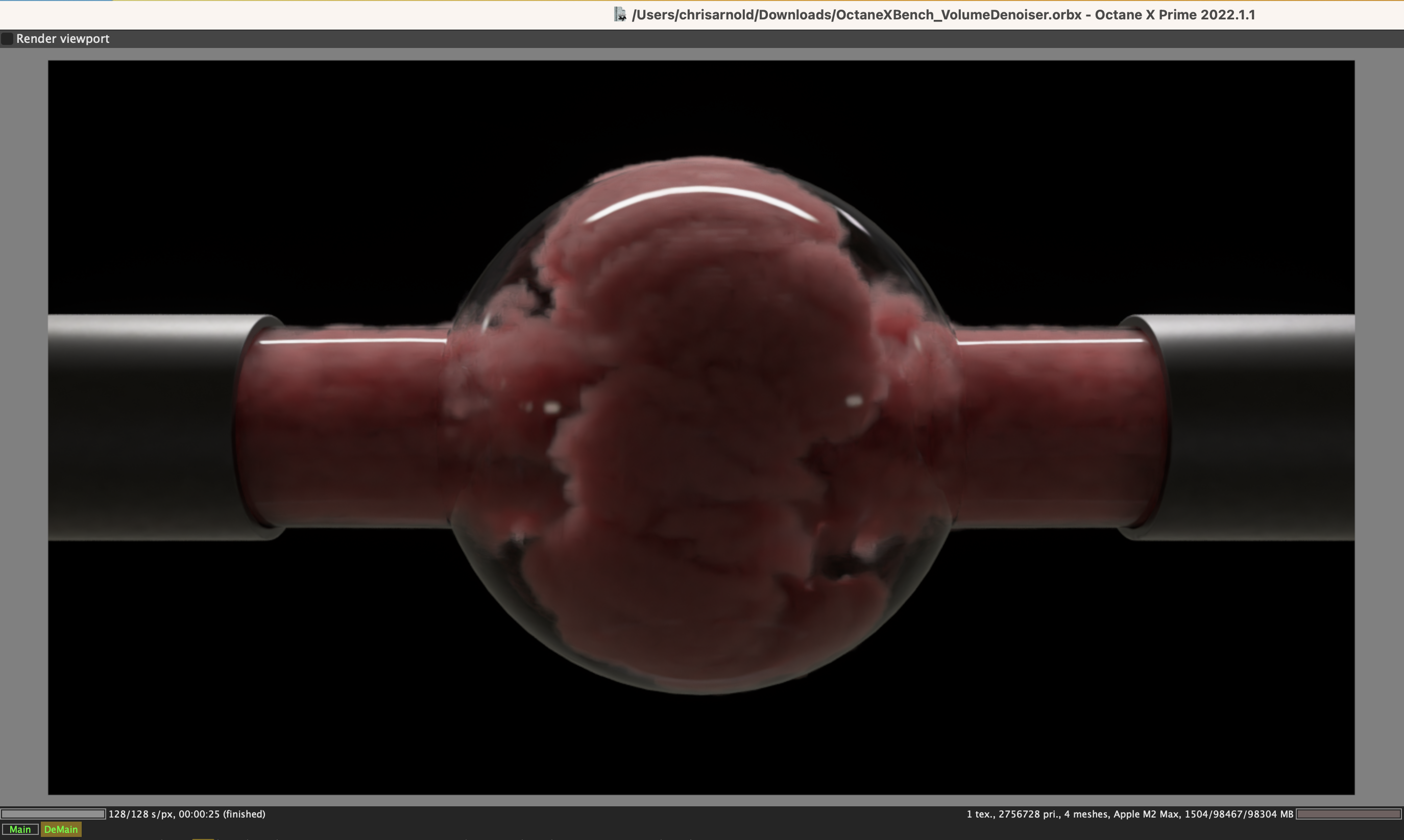

MacBook Pro M2 Max renders in 25 seconds, previously 36 seconds. A 44% speedup:
Both systems are running Mac OS 13.3.

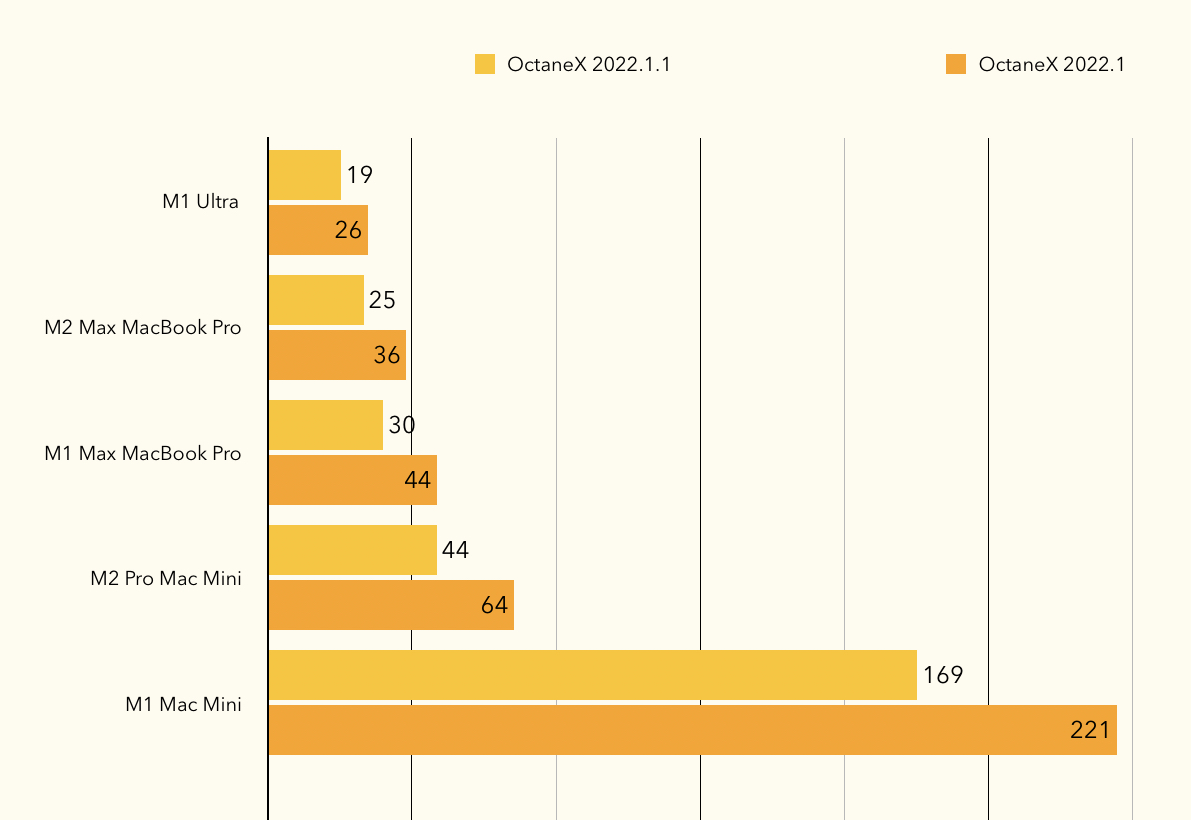

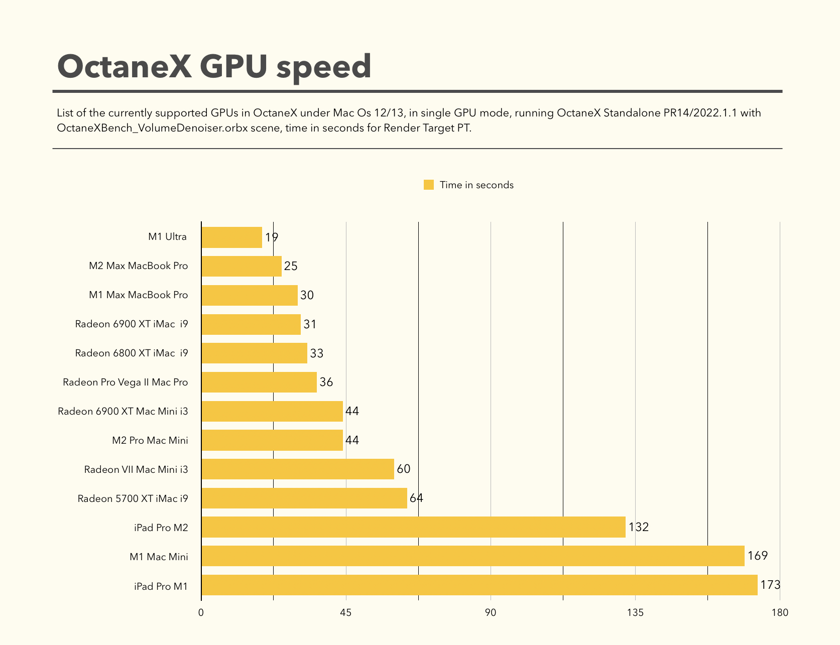

@chris_arnold: Thank you :)
Here is the updated chart with OctaneX 2022.1.1:
And a comparison between OctaneX 2022.1 and 2022.1.1 for Apple Silicon M1/M2 only:
Happy Mac GPU rendering!

This is kind of meaningless without a comparison to anything Nvidia
Good job improving render times
But it'd be more helpful to know how different Macs compare to various CUDA cards.
Is an M2 Pro or whatever as fast as... a 2080ti? 3050? 4020?? Who knows.
