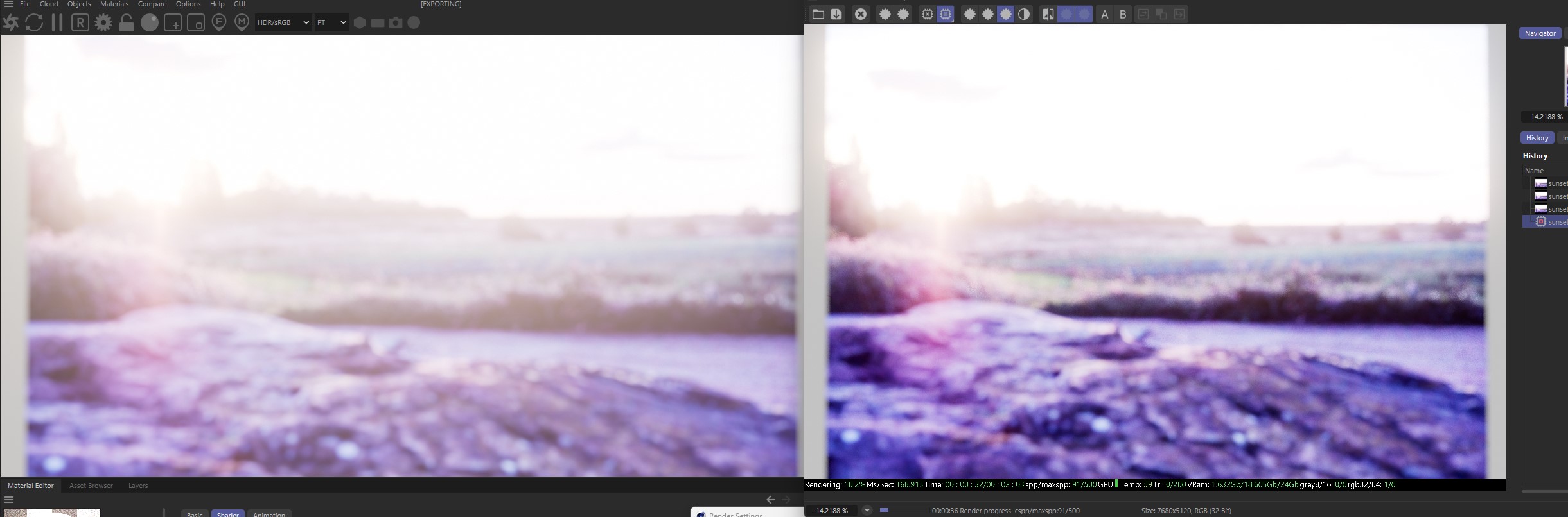

Can anyone shed any light as to why im getting such a large difference between my live view and my final picture viewer renders here? Ive never seen such a big difference between the two before.

No color pipeline, all default settings, just boring old 8bit srgb renders.

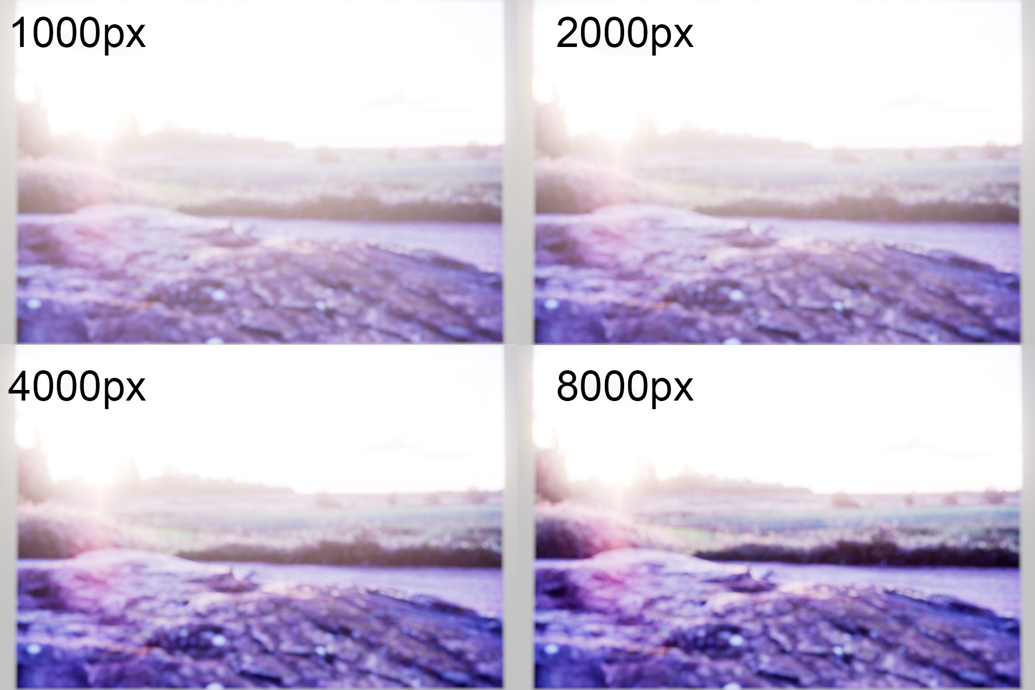

I've narrowed it down, the image brightness changes as the render resolution changes (!?) My guess is that the glow post effect isn't scaling properly somehow. This is naturally screwing me over as all my tests are at 1k res and my final output is 8k. So it isnt a live view vs final render difference, its a resolution difference. To reproduce, just render the project at 1k then 8k.

Yes, this is an old an well known limitation of Post Effect.
It is not smart enough to take into consideration the resolution scaling.
The only workaround that I know is to save the mid/low res Post Effect as separated AOV, then gradually over scale it to the final resolution :roll:

What about preview post effects in Octane Live Viewer using lock resolution mode at 100% ? It should render them using final resolution set in render settings.

SSmolak wrote:What about preview post effects in Octane Live Viewer using lock resolution mode at 100% ? It should render them using final resolution set in render settings.
Thats what we'll probably do from here. Get it close normally, then do a final full res, but scaled down LV check to get it back where it was. Its just annoying that well need to then toggle this back and forth during subsequent changes.
