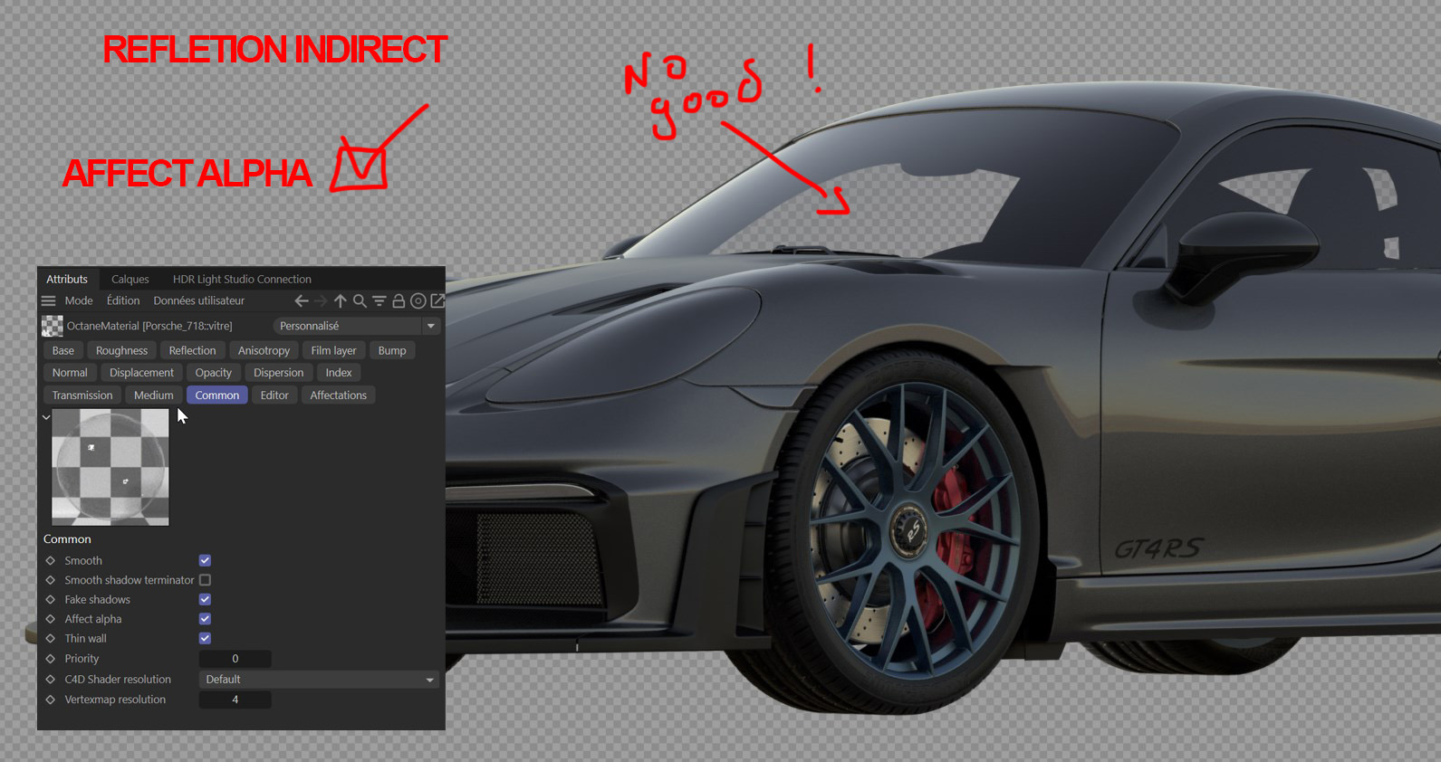

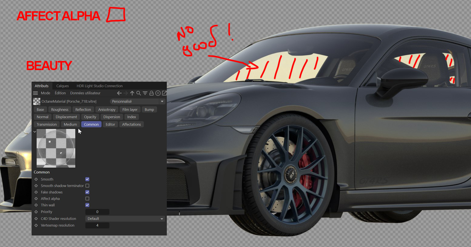

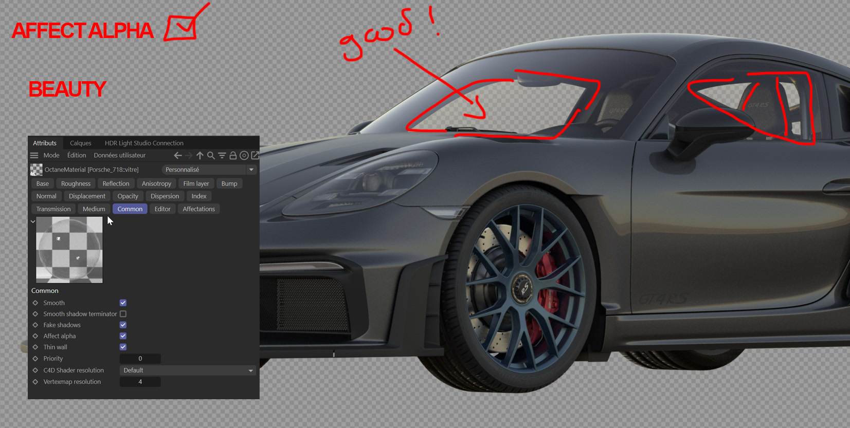

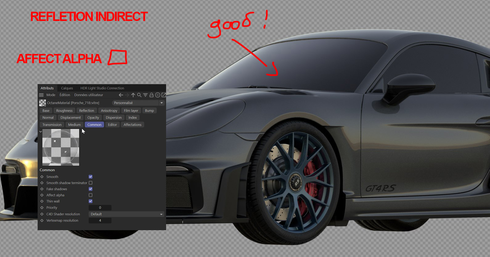

Hello, I would like to have the reflection pass in the AOV without alpha, but keeping the Beauty with alpha, possible?
if you have any ideas…
thank you very much
here are some screenshots to show you:

my suggestion is to render the beauty and reflection AOVs with Affect Alpha option disabled, then use the C4D Takes system to enable the Affect Alpha option, and reduce the max sampling via Overwrite kernel Setting tab, to only obtain the correct alpha you need.
