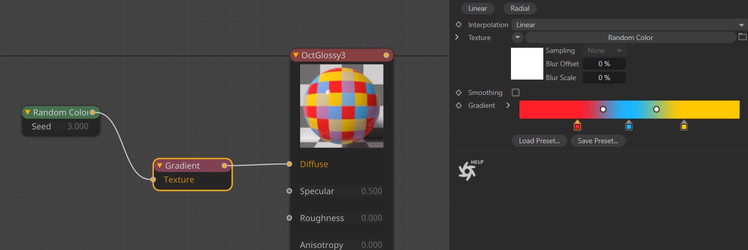

Random Color node works only with MoGraph in Render Instance mode or Octane Scatter.

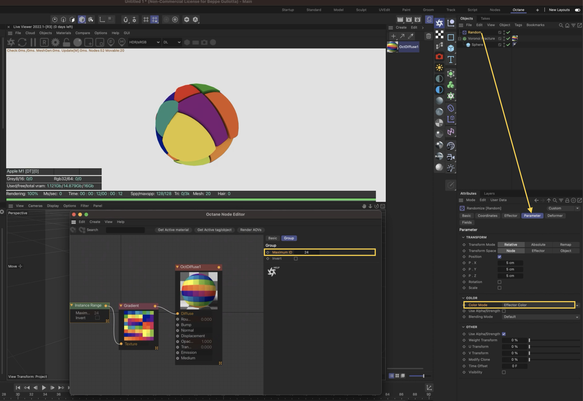

For Fracture object you can use the Instance Color node, set the Maximum ID as the number of objects created by Fracture, assign a Random effector to Fracture, and set the Color Mode to Effect Color:

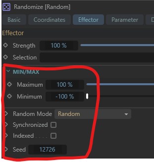

Thanks, it works but it looks like gradient, how to give randomness.
Manually color set or any auto option...?

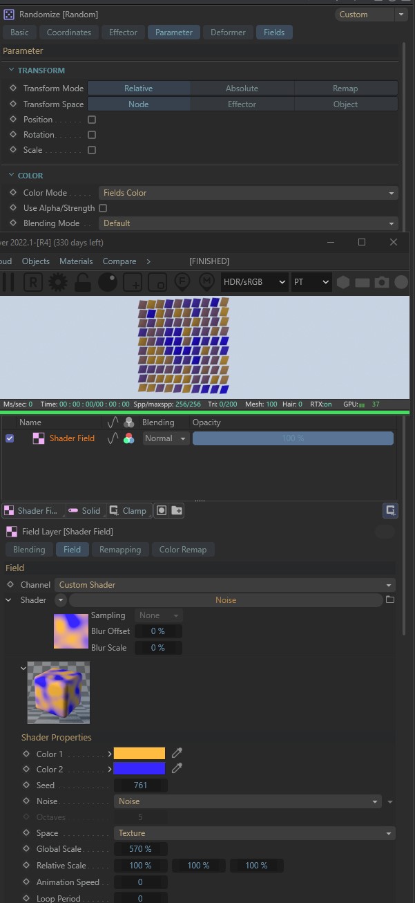

You can use Color Shader with Shader Field in Random Effector using Fields color mode so all colors can be randomized by noise :

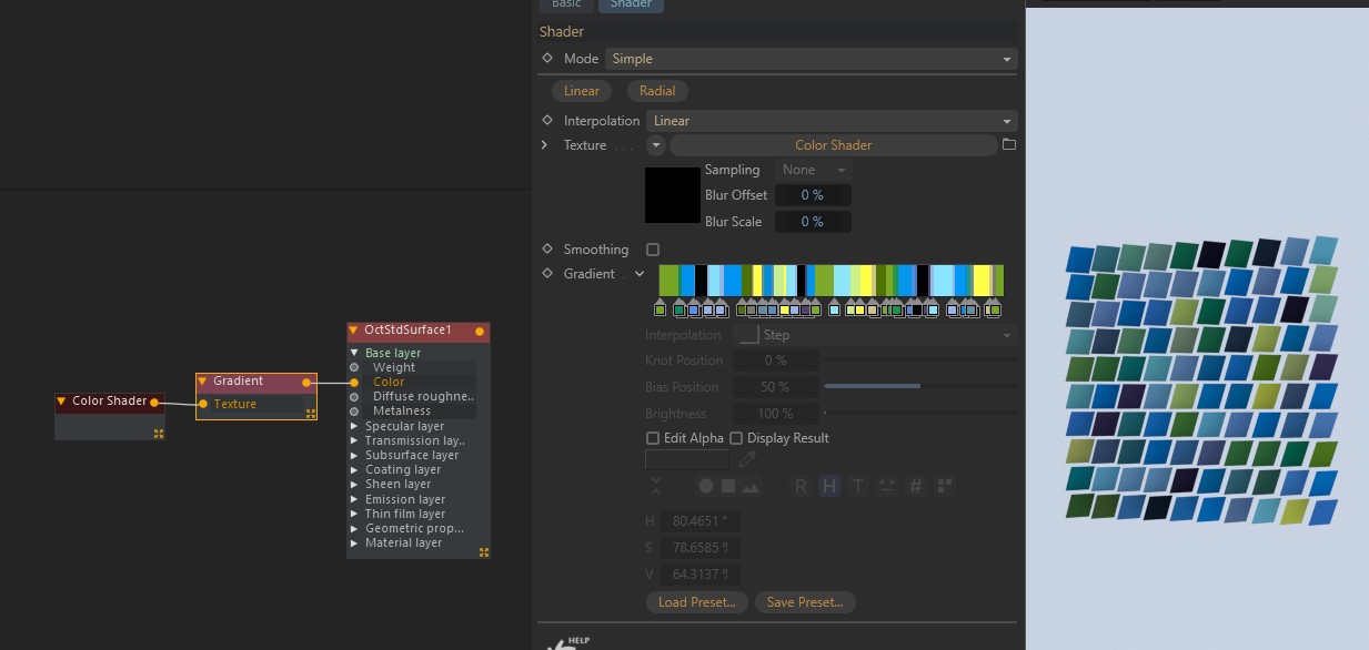

This works too ( Random Effector color mode : Effector ) :

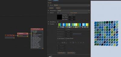

You can randomize easily here :
