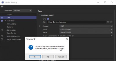

Are you sure that's correct notation? This is what I get when I try with C4D renderer in main buffer!

Well, I'm pretty sure in the main Save option it works fine. And it's usually all caps? When you select the default tokens they're usually all caps. For some reason in the Octane Renderer settings, they always change to lower case. The problem only seems to occur when I don't save using the C4D option and instead only save through the Octane AOVs.
