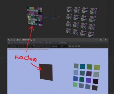

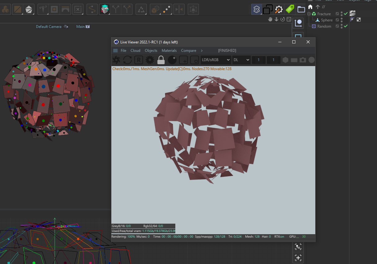

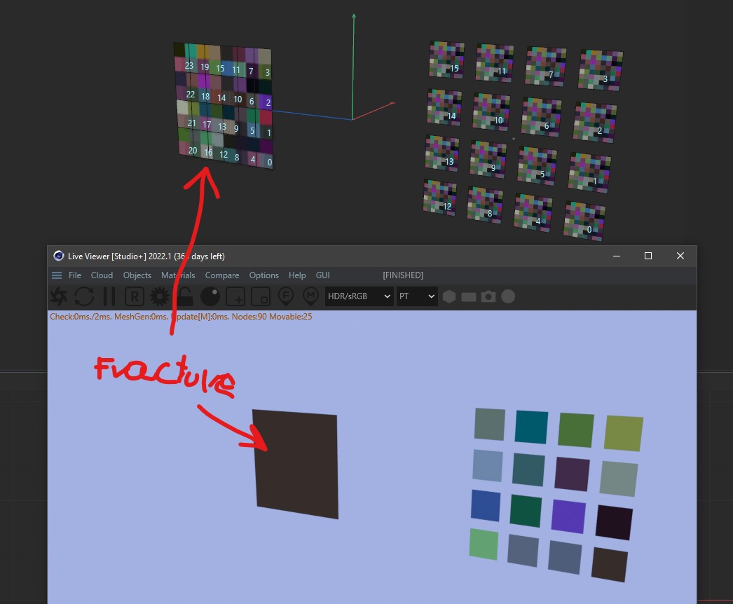

All Octane nodes related to instances doesn't work with Fracture in Explode Segments mode - random color, instance range, jittered color correction, Morgaph shaders...
Tested in previous Octane versions too
Fracture and Cloner :
Instance Range works with Fracture but only when Random Effector is applied in Effector Color Mode. Other Instance related nodes doesn't work even with Effector.
