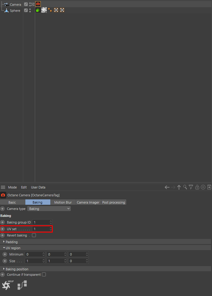

I am looking to bake the textures on a plant to a unwrapped UV map.
However the UV set tag on the camera does not seem to work, in fact having two UV's on a complex object crashes cinema all together.
Is it at all possible to bake one UV to another UV?
R23
2021.1.6 (R6)
Octane Baking - UV Set

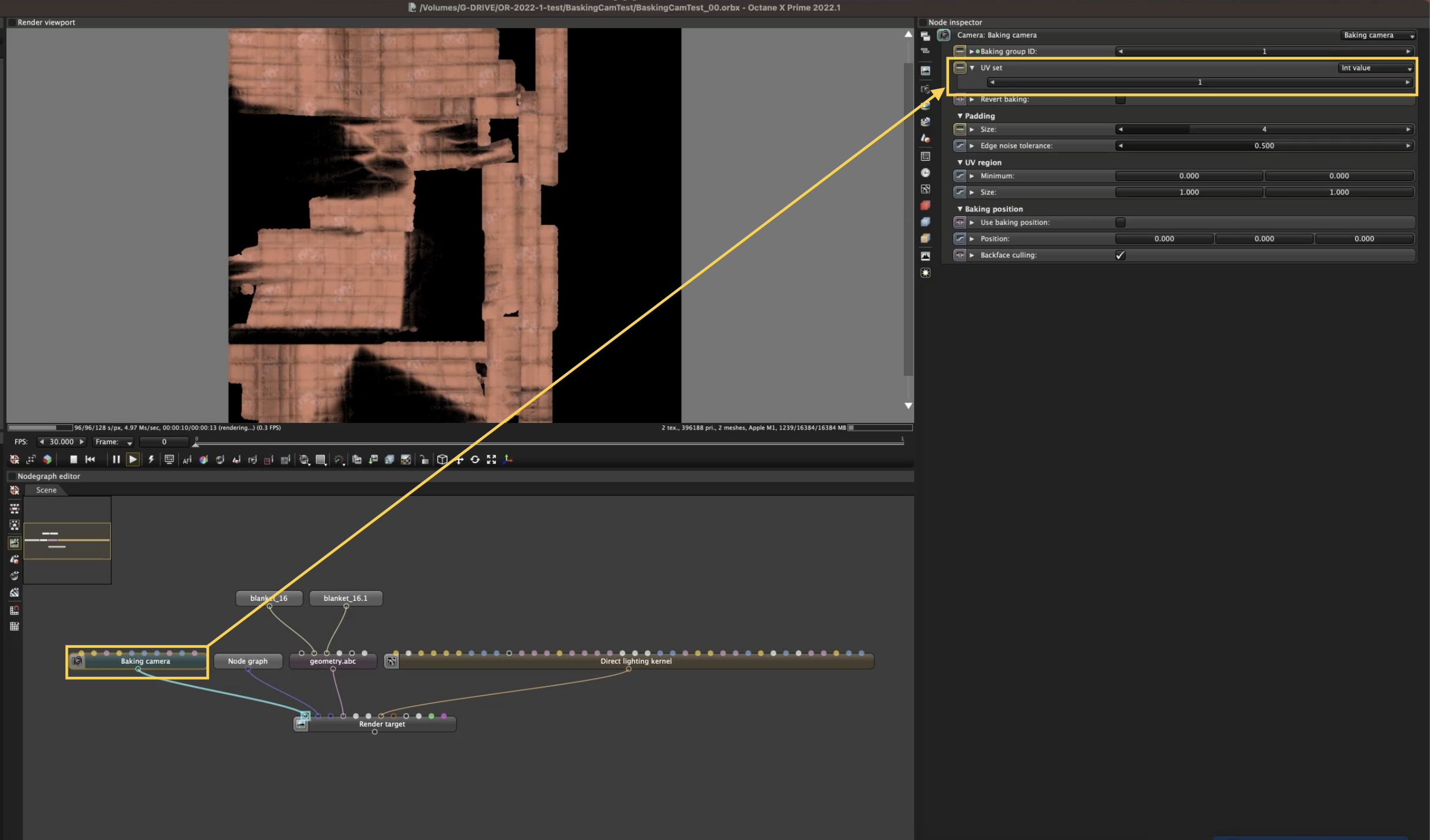

you can prepare your Baking scene in c4doctane, and export it to Standalone via Render Settings/OctaneRender/Main/ORBX EXPORTER.
Then, in Standalone, just select the Camera node in Node Graph, and change the UV set in the Node Inspector: And render the baked results from Standalone:
https://docs.otoy.com/StandaloneH_STA/S ... ight=batch
