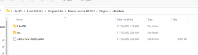

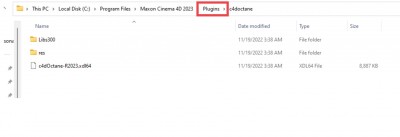

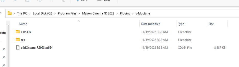

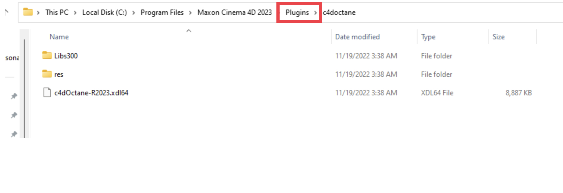

Please, also share a screenshot like this one, that shows both the c4doctane directory opened, and the entire installation path, thanks:

Hi, here is the console output and the screenshot:

Installed files are not from demo version. Check the downloaded archive again.

Please, also change the name of the folder from Plugins to plugins in lowercase:
