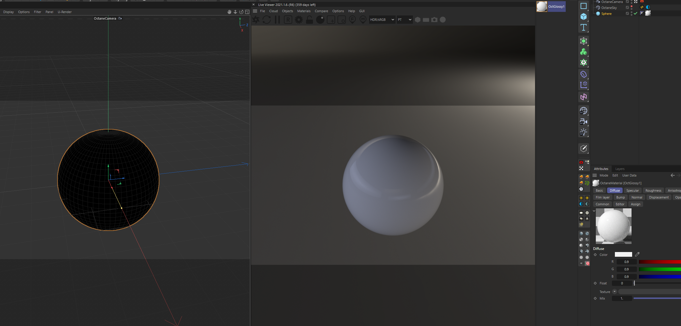

Sure, hereby attach a screenshot of a new geo with new material applied with (R6) in R26.
In case it helps, I actually see the sphere white for 1sec or even less, and then it turns black.
