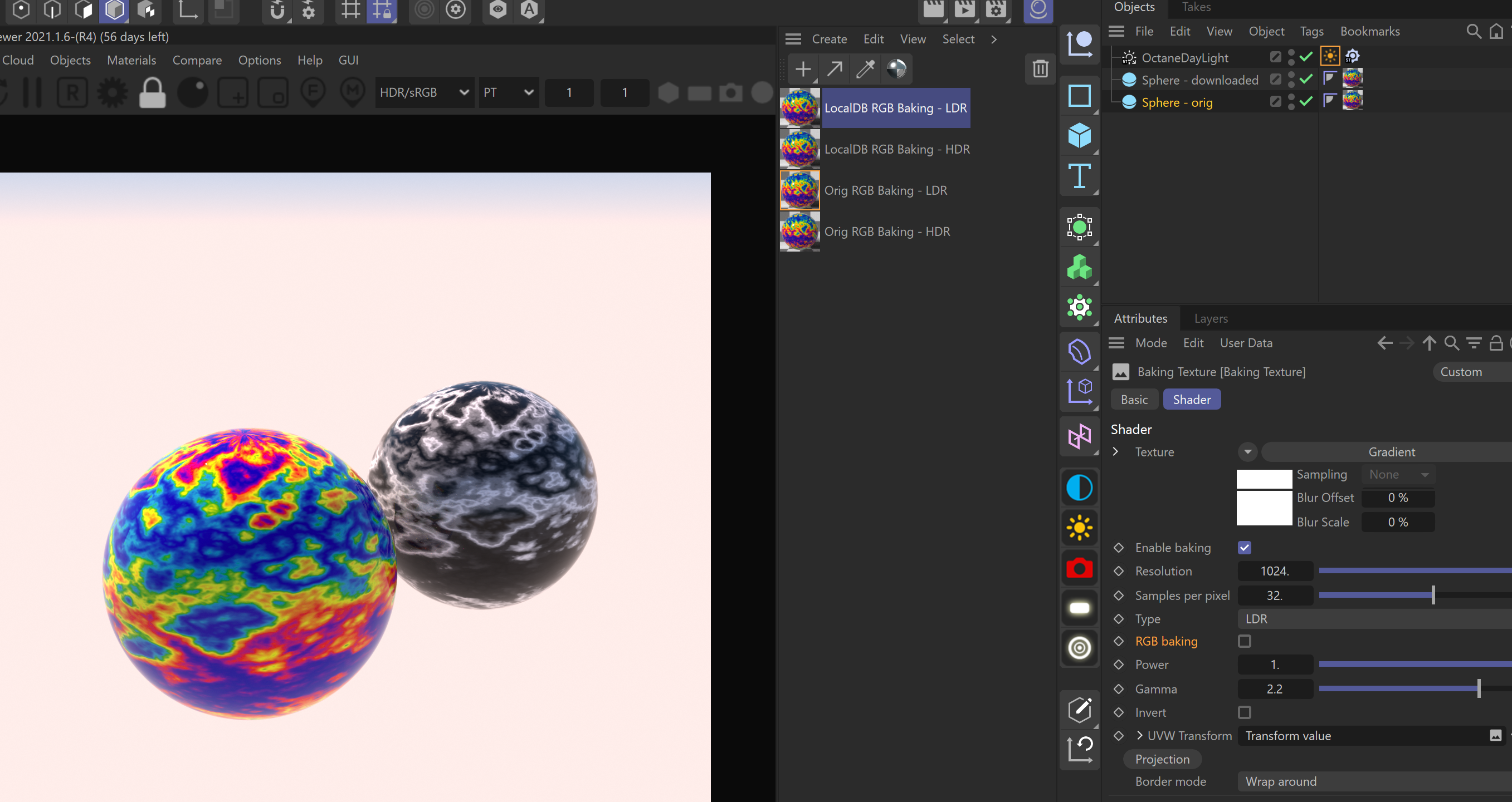

Another one
The RGB Baking checkbox in the Texture Baking node resets to OFF when uploaded to the LocalDB and downloaded again.
See attached file.
C4D R26.015, Octane 2021.1.6-R4, Win10
Methodology:
Create new Universal Material
Add Marble node (also tested with OSL texture)
Add Octane Gradient, add colors in, connect Marble to Octane Gradient
Add Baking Texture node, connect Octane gradient to Baking Texture, Baking Texture to Albedo
Check "RGB baking" in Baking Texture node
Upload to LocalDB
Download from LocalDB
RGB baking is unchecked. Weirdly the thumbnail doesn't update, but it renders grayscale.
RGB Baking Issue.zip
(81.36 KiB) Downloaded 101 times
