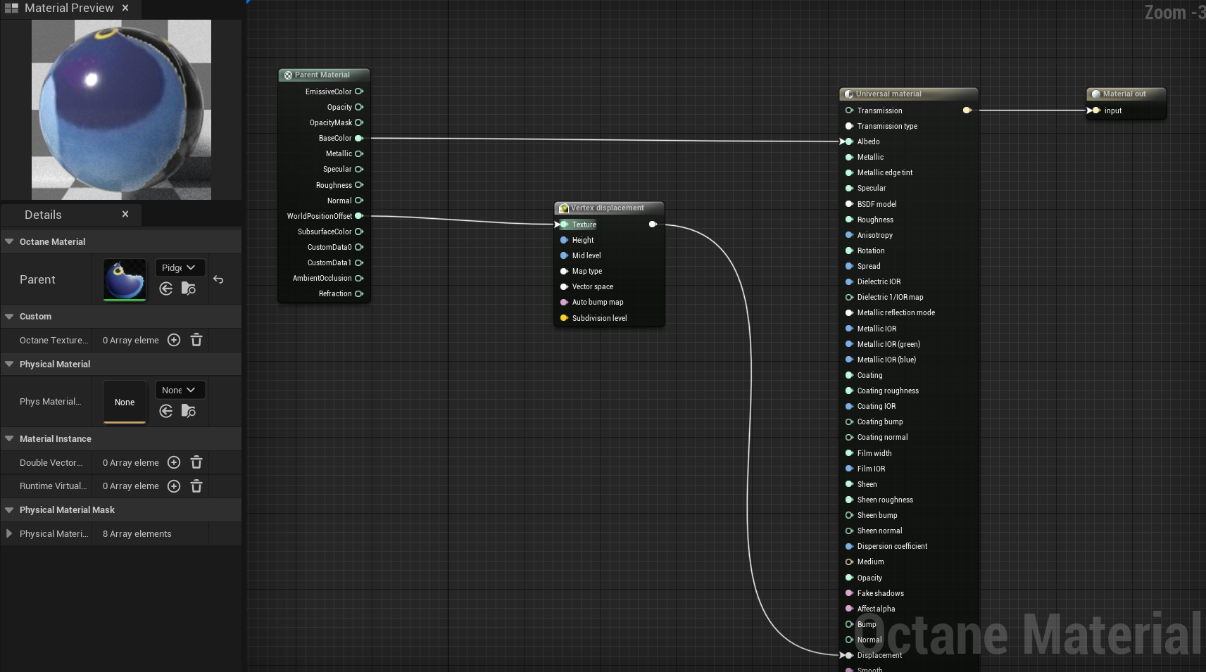

Octane Materials can have a displacement node. The vector displacement nodes in octane can support OSL texture nodes.joshuamkerr wrote:Hi Chris,
Thanks for the reply. It's a tricky pronblem since tesselation was removed from UE5 so I'm looking for solutions to using materials to deform meshes. Nanite is of course great for single objects but my deformations are media textures and move, whichso far I'm not sure how to do in the new software other than WPO. Maybe a bump offset node might help or similar. Do you know any methods I could look into that are suppoorted by Octane?.
Otherwise I may have to look at a more complex workflow like importing an alembic geometry from another software package like blende ror houdini.
Which means you can pipe through the deformation via the parent unreal material to the Octane Material.
Should look like this:

Yes I saw you popping up the comments the other day. The render did take a while. I did as much optimising as I could in the time I took to build the scene (lowering texture sizes mainly). I'll happily send you the project but I'm not very clear on the most efficient way to do this. Do you simply need the whole unreal project folder? It is 18GB in size.
Regarding the WPO issue, I am using an octane material instance to try to convert the WPO to a displacement but it simply isn't getting me any results. The only thing that seems to work is the auto bump boolean in the vertex displacement node but the results are too harsh. I have attached two pictures below that shows the setup.
https://drive.google.com/file/d/1IsBp11 ... sp=sharing No auto Bump
https://drive.google.com/file/d/1yZuDK_ ... sp=sharing Auto Bump enabled
