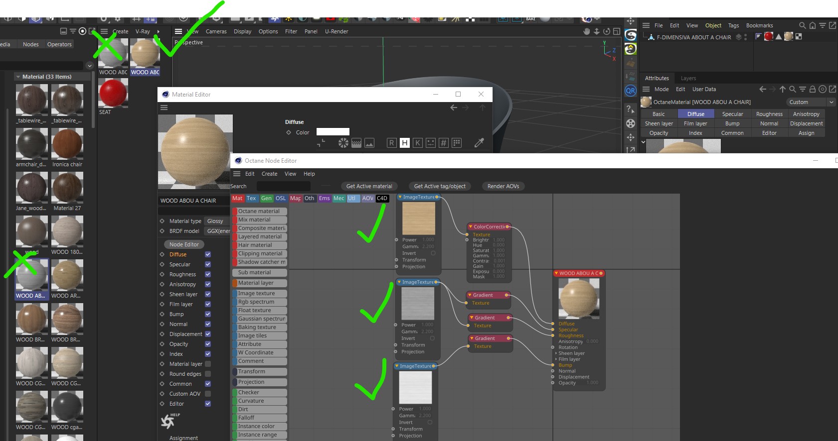

I am facing an issue recently. On r25, there is C4D Asset Manager in which I have already successfully saved several shader asstes.
Recently I find a weird behavior: the shader is being saved with all textures replaced by only one texture file.
Please refer to the screenshots.
Can't say if it's an issue on C4D or plugin. I haven't upgraded from R25.117 since never.
Regards,
Shader saved on Asset Manager and reimported with wrong textures file names.

Kalua wrote:Hi, Aoktar
Regards,
Try with latest build(2021.1.6-R3). Send me a pre-saved sample project if still happens.
Regards,
Thanks! It's solved!
