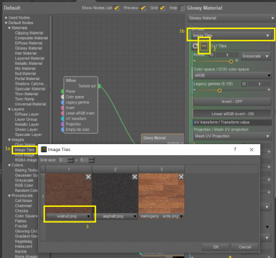

  • Image Tiles node support
    • This allows you to create a texture from multiple image files. Each image is assigned a range of UV coordinates based on its position in the grid.
    • The Genesis 8 characters, at least, have UV coordinates that are set up to be used in this way, so you can create a single material that covers all of the skin surfaces of a figure.
    • At present there is no automatic support to help you do this - you will need to manually set up an Image Tiles node for the diffuse images, the normal images, etc.

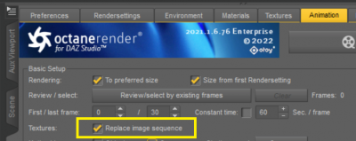

  • Image file name replacement during animation can be disabled

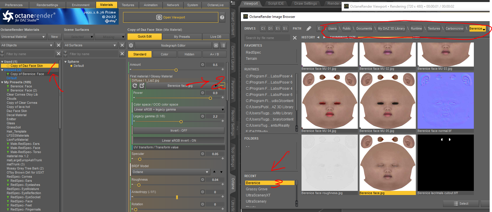

Love the new image preview feature, this opens options to make visual changes and prompts for action. In one case I realized that I needed to create a normal map from my image and was able to do so and save in the same location.

Tugpsx wrote:Love the new image preview feature, this opens options to make visual changes and prompts for action. In one case I realized that I needed to create a normal map from my image and was able to do so and save in the same location.
Where is this feature?
I've been hunting for ages looking for it, but can't find it.

Tugpsx wrote:
Oh`, there it is... I thought that had always been there, those three little dots are sometimes hard to resist clicking on.
Thanks.
Thanks.[/quote]
Grab program "Materialize" and you can create the missing maps to produce great materials.
