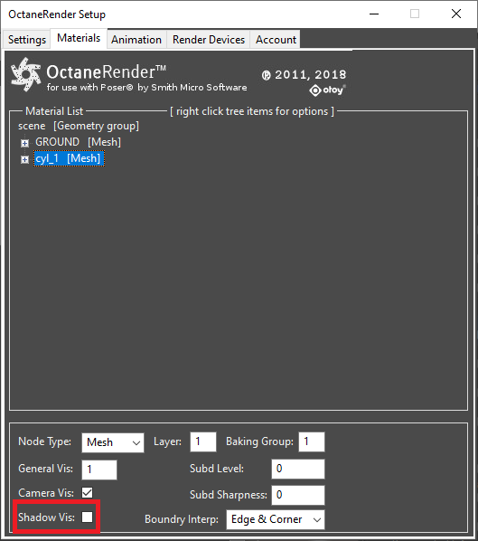

How do you prevent a object from casting a shadow. Or casting a shadow on a selected object.

in the Material Setup, bottom section, you can tick or un-tick the Shadow Visibility.
Setup:
With Shad.Vis. ticked:
Un-ticked:
Hope that helps.

Regarding the Shadow Visibility - there is also the Mesh->Shadow Vis. checkbox that can be turned off. For reflections, I don't think this is possible, although you could play with the material reflection settings.
