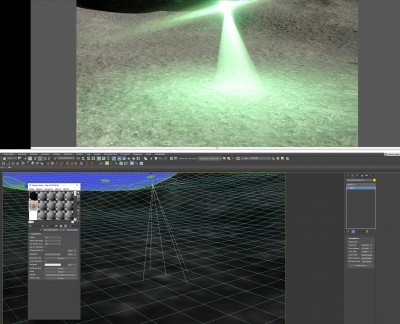

Do you have a sample scene with a volume spot light where it looks like in the image attached as a blue sport light.
It seems there is no connection between volume, light, light spot, cone size. Thank you!
