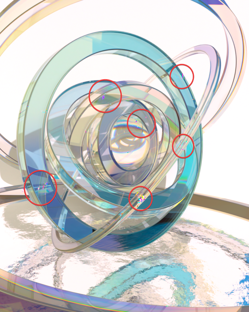

I'm testing a scene that contains lots of specular materials and having weird colorful noises.
It doesn't go away with any settings
These are the settings I tried but none of them fixed the issue...
There is no scatter/SSS materials in the scene
Also, denoiser didn't really do anything but getting rid of grainy noises
Am I missing something???
Path Tracing / PMC
Max. samples 1024-4096
Diffuse / Specular depth 10-50
GI clamp 1-10
Caustic blut 0-1
Denoiser
Adaptive sampling ON (I also tried tweaking its Min samples higher)
Noise threshold 0.01-0.05
Hot pixel removal
Weird colorful noises

Oh, sorry for the confusion haha. The settings I wrote were just "range" I tried.
Not like, seperating into two parts (Path tracing and PMC)
Some of options I tweaked seemed not related but I just needed to anything I can to fix the issue.
Apparently you are right! It wasn't an issue related to sampling issue.
It was the lighting issue... I used colorful HDRI as a light source.
When I removed it, it was fixed.
I wasn't even thinking light sources could be an issue in this case since I used only 2 lights (HDRI and Daylight)
Thank you for helping me!
