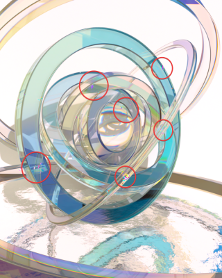

I'm testing a scene that contains lots of specular materials and having weird colorful noises.
It doesn't go away with any settings
These are the settings I tried but none of them fixed the issue...
There is no scatter/SSS materials in the scene
Also, denoiser didn't really do anything but getting rid of grainy noises
Am I missing something???

Try to play with Hot Pixels visibility.

I forgot to add it! I have already tried but it didn't work...

Apparently you are right! It wasn't an issue related to sampling issue.
It was the lighting issue... I used colorful HDRI as a light source.
When I removed it, it was fixed.
I wasn't even thinking light sources could be an issue in this case since I used only 2 lights (HDRI and Daylight)
Thank you for helping me!
