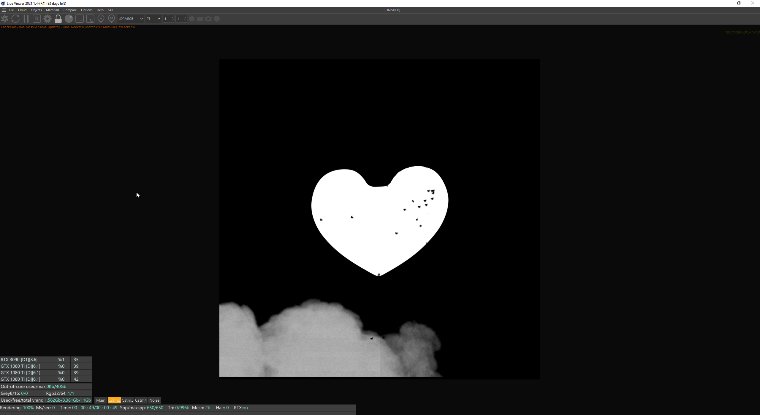

I wanted to let you know that I'm using Octane version 2021.4-(R4) and having problems with the Custom AOVs showing my VDB that isn't assigned. It appears in Primary Rays, reflection, refractions, and combined Reflection/refractions.
Is this a bug?

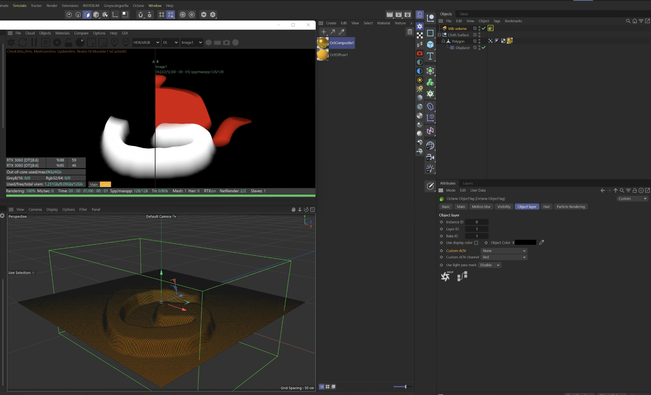

everything seems to work as expected here with volumes and Custom AOVs:
Please go to Volume/Octane Object tag/Object Layer tab, and check to have the Custom AOV popup set to None, or to a different Custom AOV number than the heart.

I had done what you said already but the problem is there.
I do have my cama crushed to .4 on 'Linear' and exposure to 2.2 which may be the reason.

about Custom AOVs and Volumes, please make sure to work with latest 2021.1.5-R2.
If not enough, please share the scene with me, even via Private Message.
