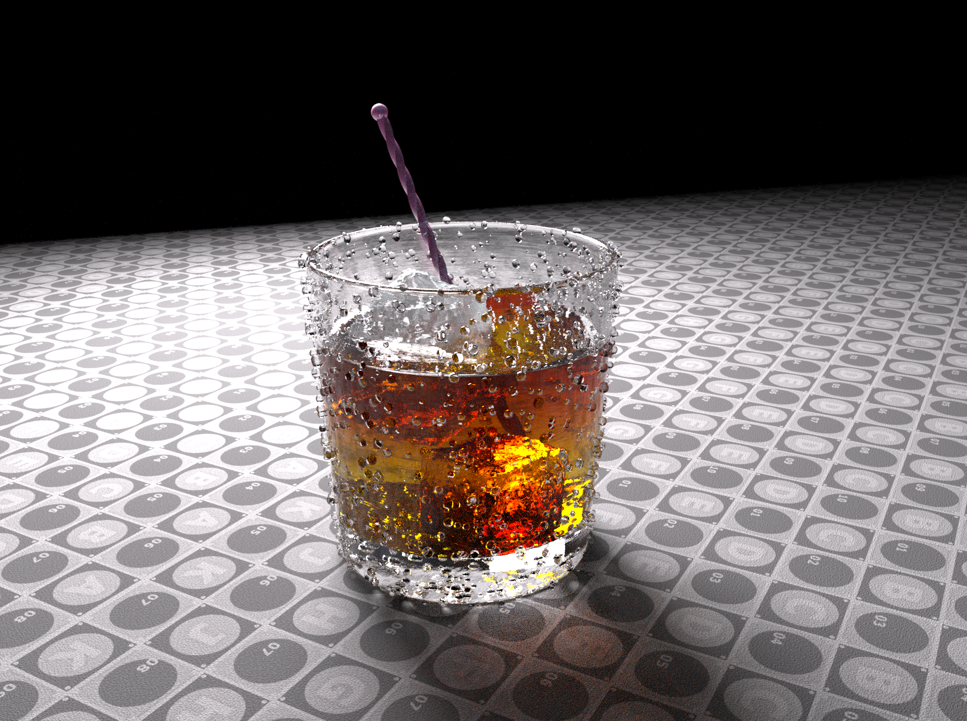

jayroth2020
Posts: 494
Joined: Mon May 04, 2020 7:30 pm
No worries. I don't have time to put a diagram together at the moment, but here is another version of the image used in the documentation, with added condensation on the outside of the glass. The condensation was accomplished via spheres cloned onto the surface of the glass object, as were the bubbles in the ice (hard to see in this image).
As the condensation is the furthest thing outside of the overall drink environment (consisting of condensation, glass, ice, ice bubbles and liquid), it has the highest priority. Next is the glass, which is followed by the ice, and, lastly, the liquid. The condensation has an IOR of 1.33, the glass 1.5, the water 1.33, the air bubbles just over 1.0 and the ice at 1.5 (to read a little stronger). The bubbles in the ice were given the same priority as the ice.
Hope this helps for now...

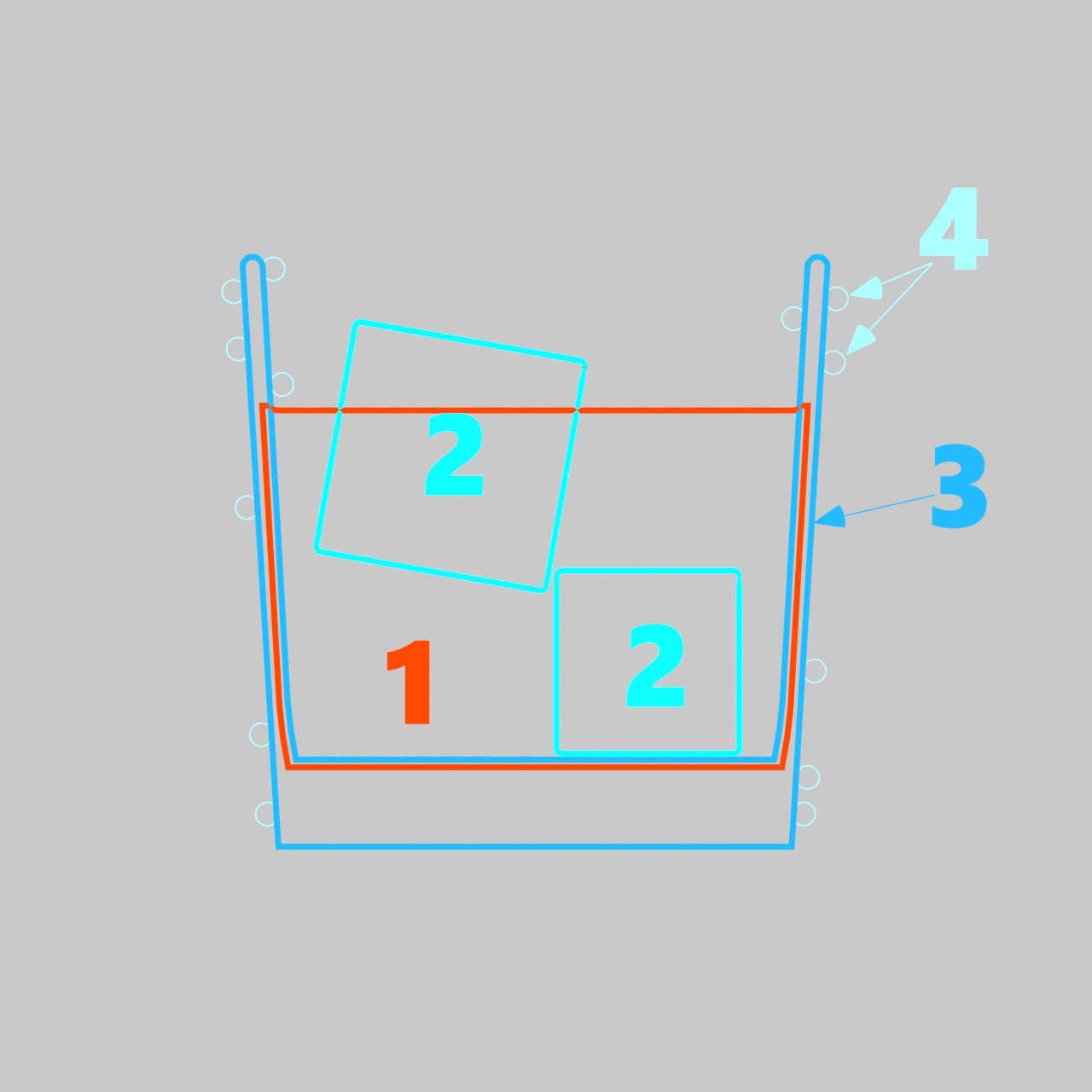

jayroth2020
Posts: 494
Here is the diagram. Each priority is called out, going outside to inside: The condensation is 4, the glass is 3, the ice cubes are 2 and the liquid is 1.
Puget Systems / Intel Core Z790 ATX / RTX 4090 / Cinema 4D

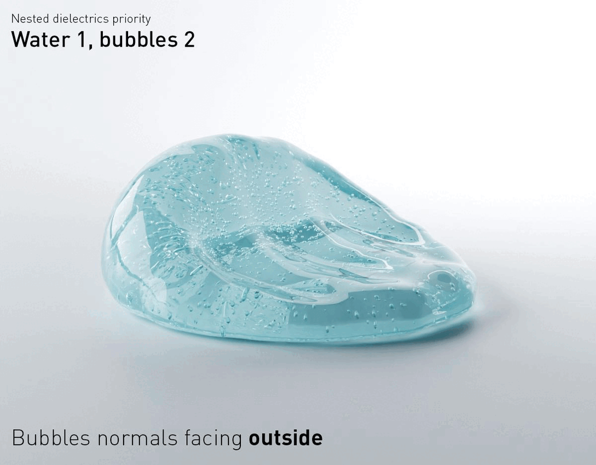

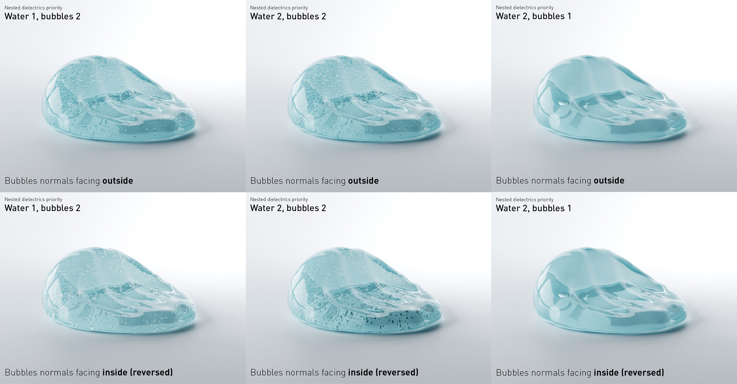

Respectfully reopening this subject because I'm constantly facing this situation with nested dielectrics, water and bubbles (working for cosmetics).
Here are a few renders. I think, according to your chart, that the correct one is the bottom left one, am I correct?
128 specular bounces, IOR for the water is 1.362 (shampoo) and 1.003 for the bubbles (air).
Would you reverse normals on the bubbles like I did on that second line?
On that same picture (bottom left), there are a few dark spots inside some bubbles, what do you think they are?
Thank you for your help!
bloomis2
Posts: 43
Joined: Thu Sep 29, 2016 3:29 pm
In this new render with more bubbles it's easier to see the dark spots I was talking about when normals are reversed
