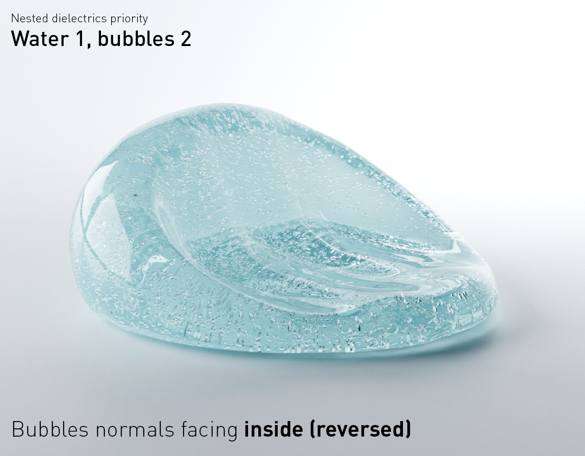

Respectfully reopening this subject because I'm constantly facing this situation with nested dielectrics, water and bubbles (working for cosmetics).
Here are a few renders. I think, according to your chart, that the correct one is the bottom left one, am I correct?
128 specular bounces, IOR for the water is 1.362 (shampoo) and 1.003 for the bubbles (air).
Would you reverse normals on the bubbles like I did on that second line?
On that same picture (bottom left), there are a few dark spots inside some bubbles, what do you think they are?
Thank you for your help!
