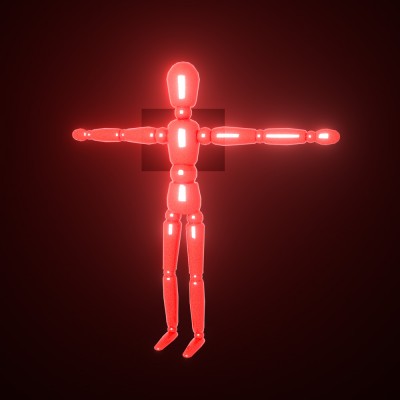

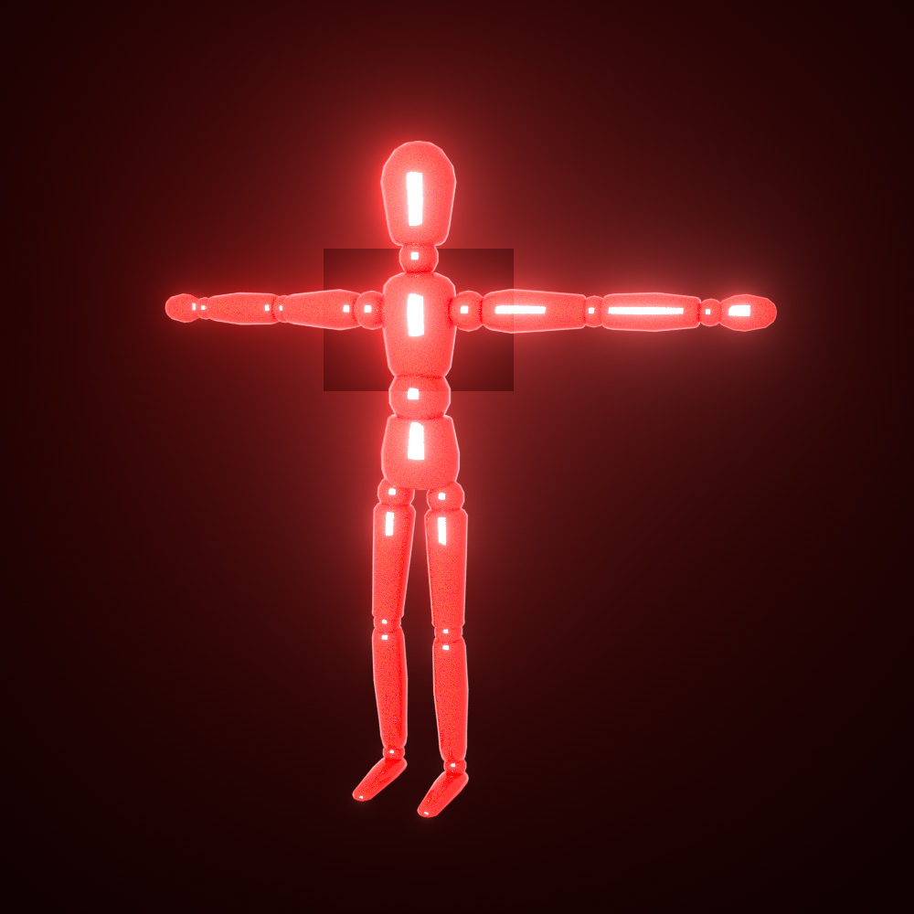

I'm comparing renders with post processing turned on in the Octane Camera tag, and it seems when Render region is enabled, the bloom etc is calculated on that crop, not the full camera view.
So if you compere a full render at 1000x1000px, versus a crop of 100x100 and overlay them, the tones are slightly off.
Is there a way to remedy this?
The reason being I need to make an amendment to one small part of the render. And rather than leave another overnight I'd just like to get the amended crop and overlay in AE
Demo
Demo

To illustrate what I'm trying to do here is the method via Standard render: https://youtu.be/eHxg9rbwRaQ
