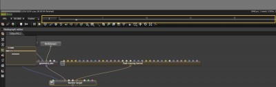

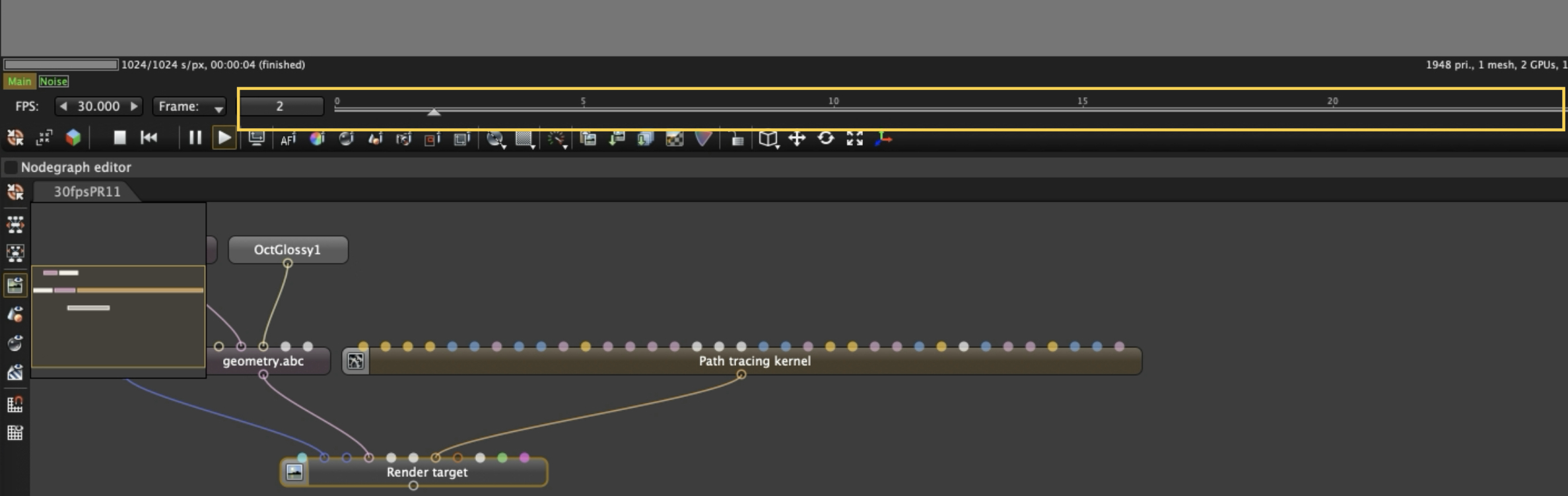

If Open in Standalone checkbox is enabled, at the end of the exporting process, the .orbx file will be opened in Standalone, and you should have a timeline in the bottom of viewport, that you can scroll to check the animation:
To go frame by frame, you can use the left/right arrow keys.
