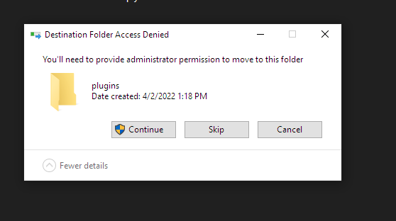

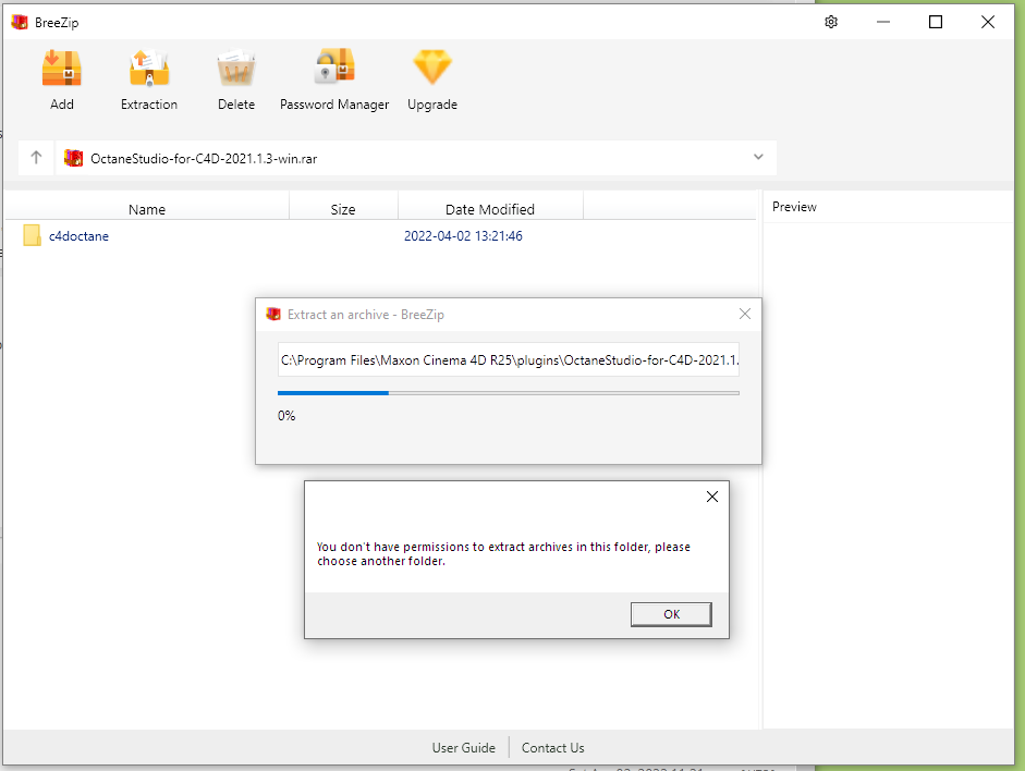

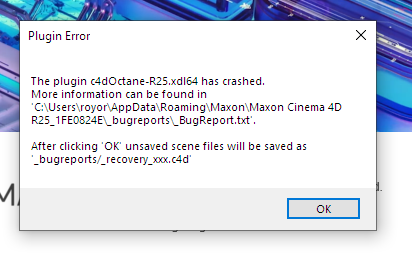

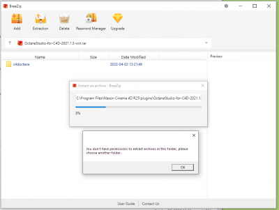

I did all of this. I've installed C4d R25.117. Inside there isn't the named plugins folder so I've created one. If I try to extract the octane plugin zip file inside, I receive the first error message. SO I've extracted the Octane zip file on the desktop and copied this folder inside the plugins folder of c4d. I've received the second alert message but I click on continue and I can copy these files. Deleted the files of other releases, but when I start C4D it crash at 31%.

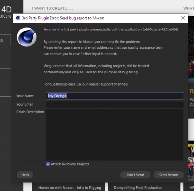

I did all the steps in a perfect way, deleting and reinstalling cinema, unzipping the octane plugin with WinRAR, delete the versions different from the 25, I still receive this message that is the plugin that cause the crash. If I remove the folder with the plugin, cinema work perfectly...

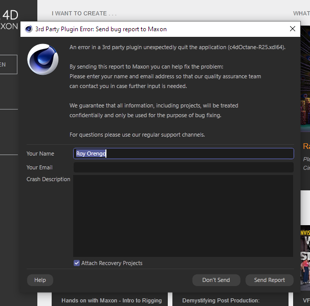

After I delete the octane plugin folder, cinema restarted and show me this message that is the octane plugin that causes the crash.

DOwnloaded the last release, and did all the steps perfectly, still the same issue. I had already opened a ticket about this, here and at Maxon...could you please communicate with them? I've sent you all the screensaver of the crash that is very clear that the problem is about compatibility between cinema and octane...
