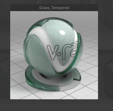

Hello,
someone could help me to replicate this material from V-ray? I was using it and it's great but I can't replicate it in Octane.
Any help could be appreciated,
Roy

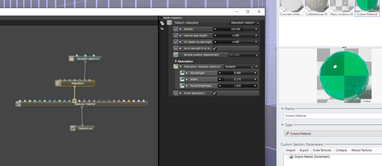

Posts: 10643
you can start from a Specular material, with Absorption Medium node, and a Gaussian spectrum, or RGB spectrum node in the Absorption pin:

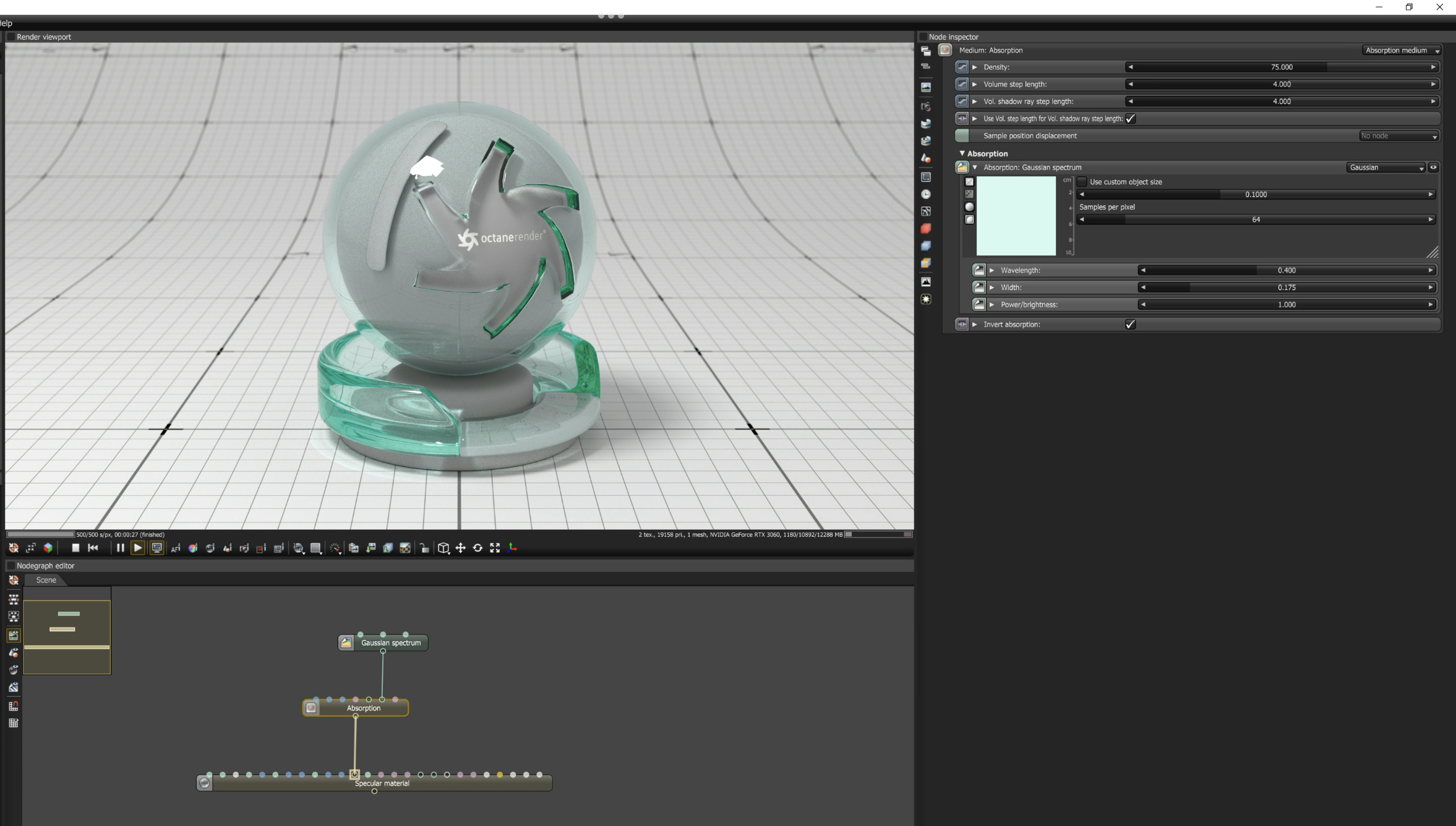

Thank you, Beppe!
But I've tried and that's my result...lol
What do I need to do more...?

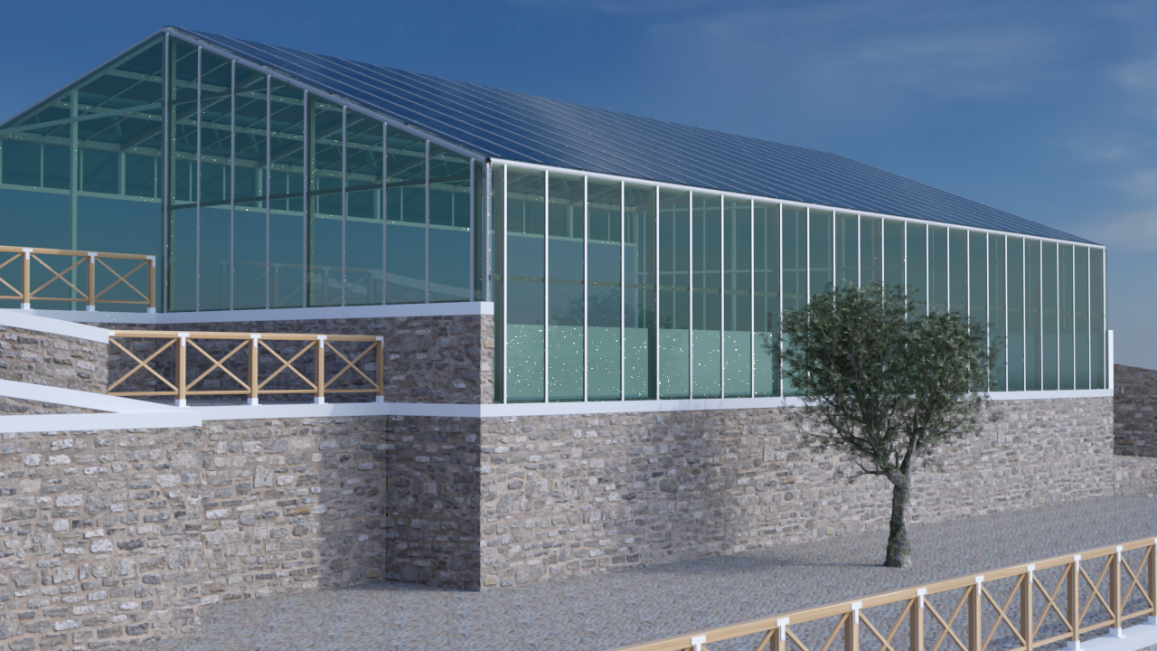

A.Lopez
Posts: 60
Joined: Fri Jan 21, 2022 4:20 pm
This one is where I need to use it!

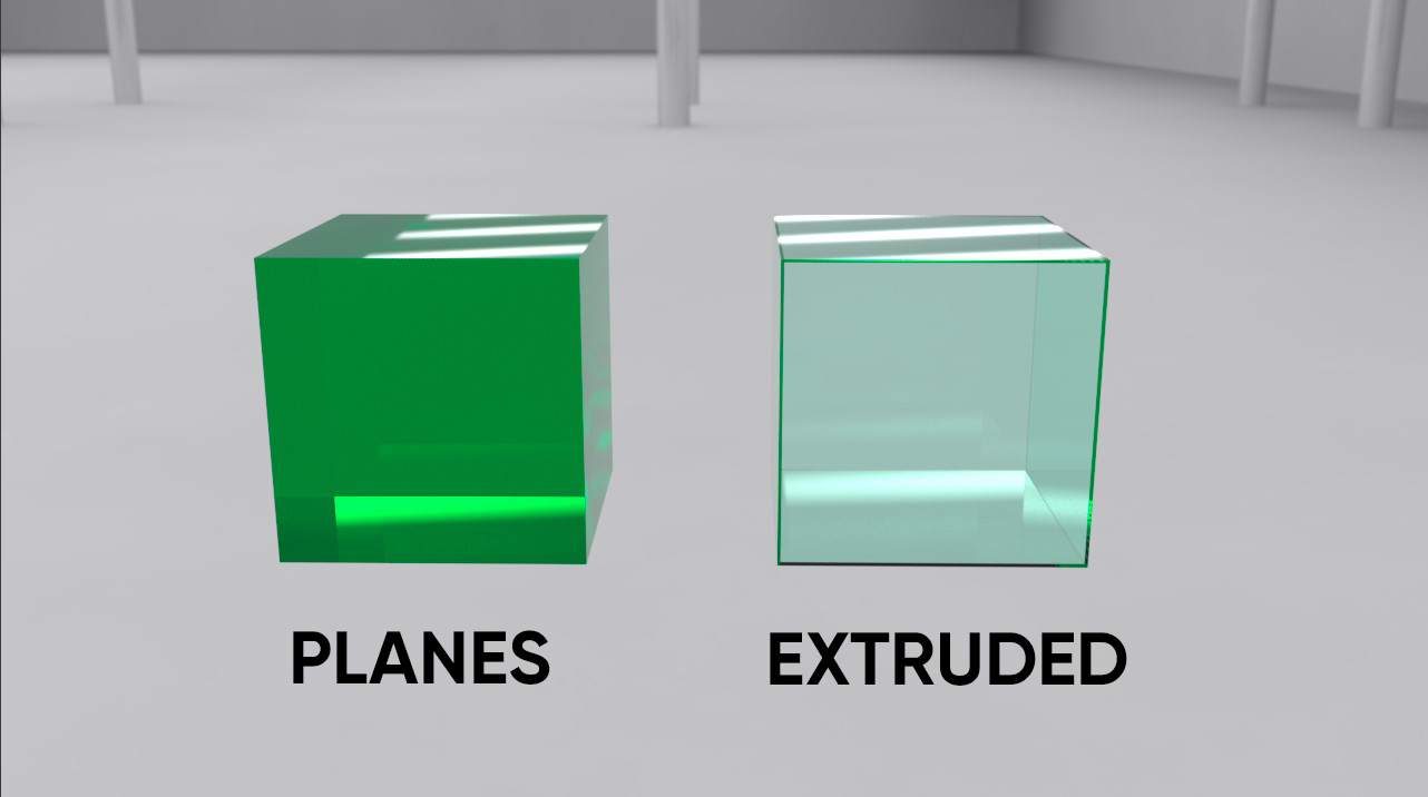

A.Lopez wrote:
The attachment Glass tempered.PNG is no longer available
I'm gonna go ahead and assume that the glass panels are just planes and have no thickness. If you want glass to actually look like glass you need to extrude it.

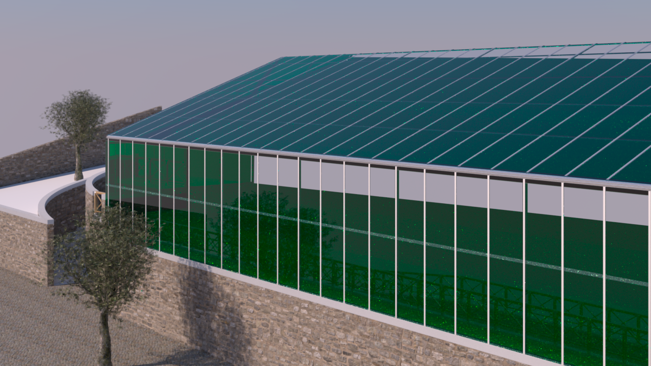

A.Lopez
Posts: 60
Yep! I've found the problem...I was using a file where I was testing the suggestion of Paul Kinane to use ray epsilon between 0.075 and 0.1 inside Rhinoceros for the large model. This option was giving me the error. Here is the result with ray epsilon by default, 0.001.
Thank you all,
Roy
