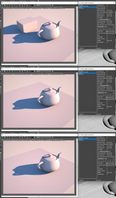

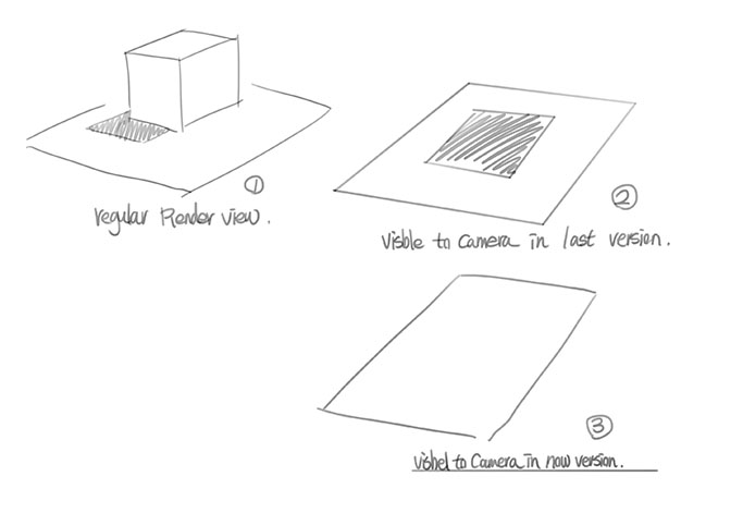

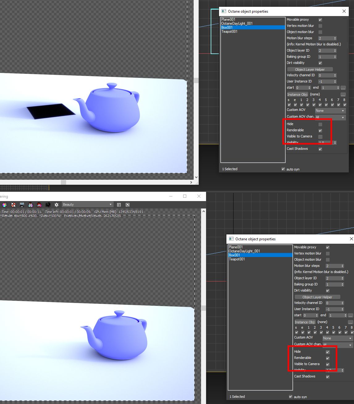

I used to use "Visble in camera" a lot in the past, and the result of rendering is that the item is hidden but the shadow is still displayed on other items,
but in the latest version, using this function will make the item and the shadow hidden at the same time.
Is this feature canceled, or moved to other options?

Can you use the Raytype switch node plugged into the material opacity? It should give more control.

jobigoud wrote:Can you use the Raytype switch node plugged into the material opacity? It should give more control.
Wow I have never used this node before, thank you so much. learned new knowledge through you.

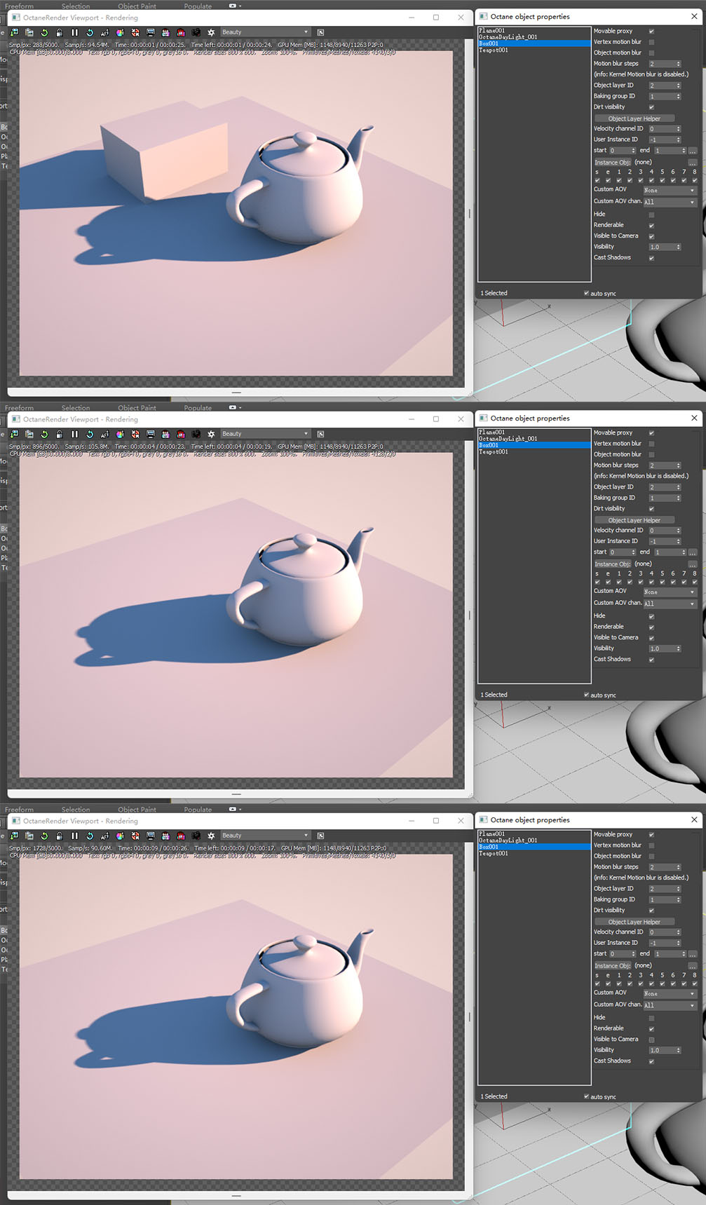

Thanks for your reply, but in my version it shows like this
I used the 3dsmax 2021
