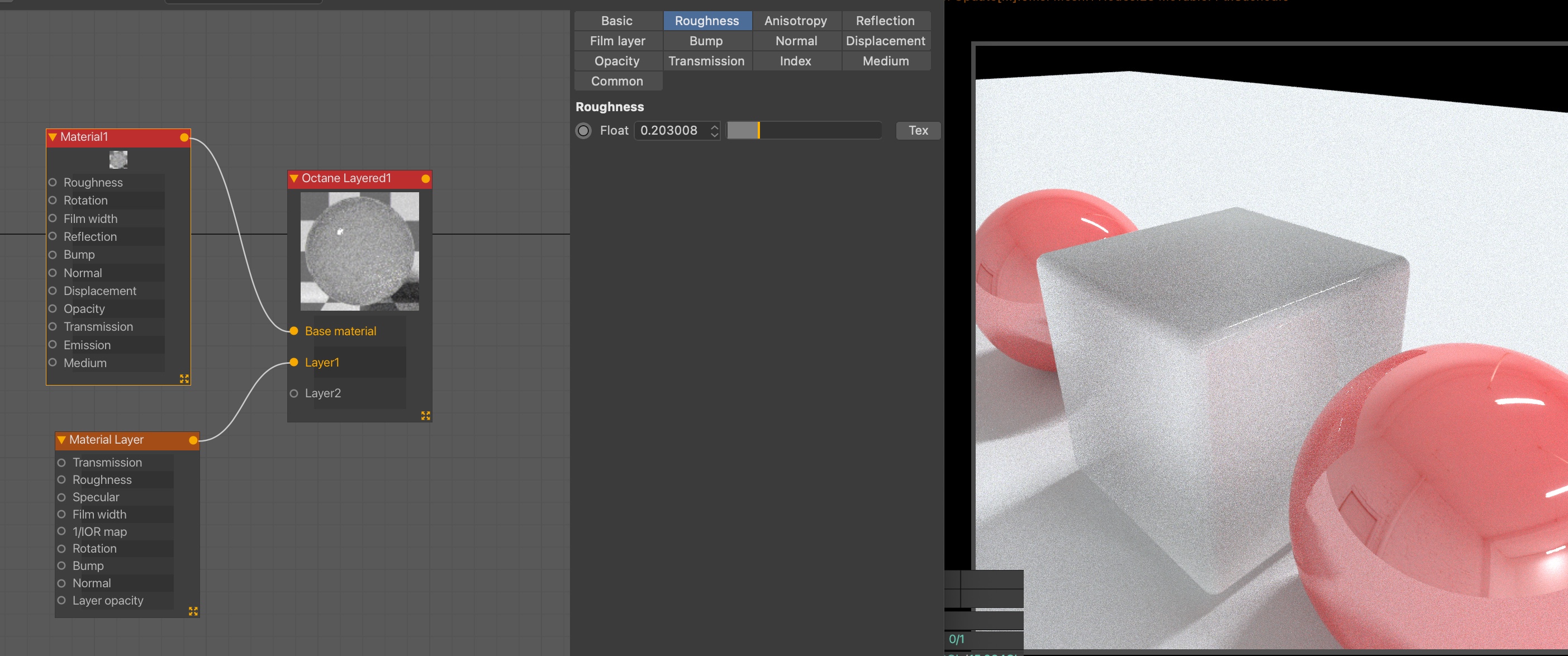

Thanks, I haven't used layered material before. Would it work something like this? I can't get a stronger reflection
layered material
layered material
