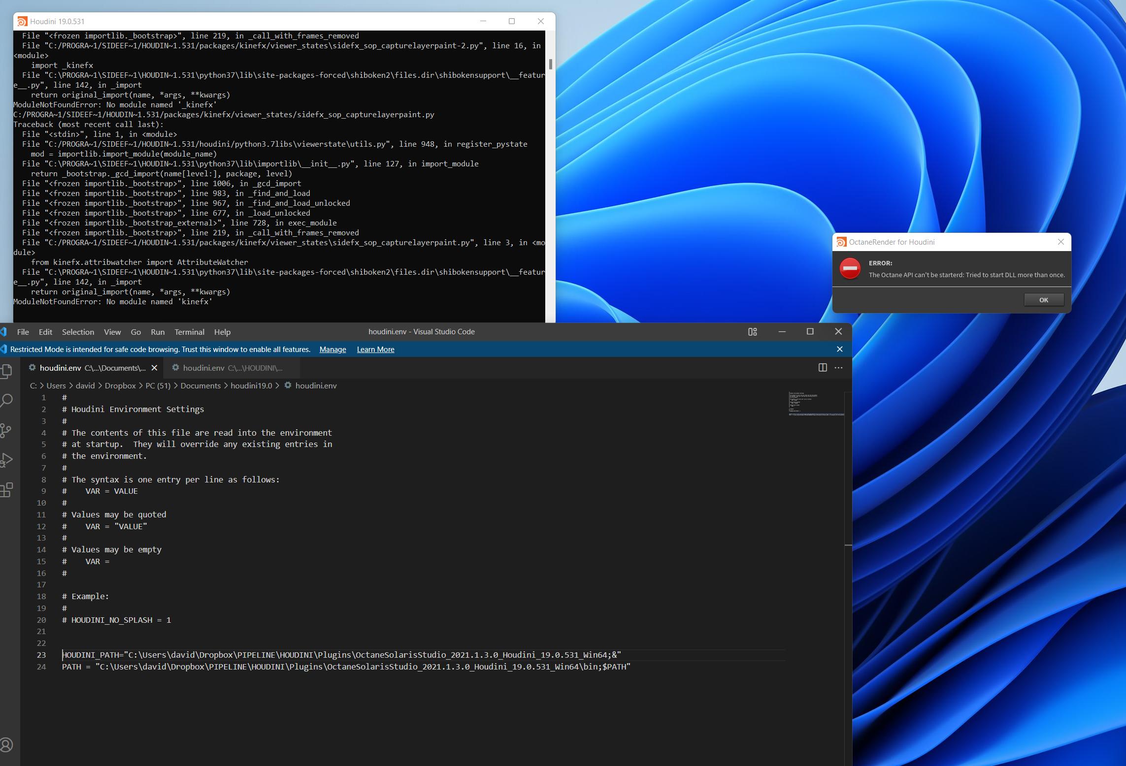

I've put
Code: Select all
HOUDINI_PATH="C:\Users\david\Dropbox\PIPELINE\HOUDINI\Plugins\OctaneSolarisStudio_2021.1.3.0_Houdini_19.0.531_Win64;&"
PATH = "C:\Users\david\Dropbox\PIPELINE\HOUDINI\Plugins\OctaneSolarisStudio_2021.1.3.0_Houdini_19.0.531_Win64\bin;$PATH"
in houdini.env in my hsite path and Octane does not load in solaris, so I've put this two lines in houdini.env in home folder and here is the result
Maybe I'm doing something wrong, I always use packages for Arnold, Redshift ... Is there a way to load octane delegate with package ?
Any suggestion please ?

That's because Solaris is not a separate install. You need to merge it with the main plugin. If you are using packages for Octane, you don't need to edit houdini.env
ok thanks for your help :)
